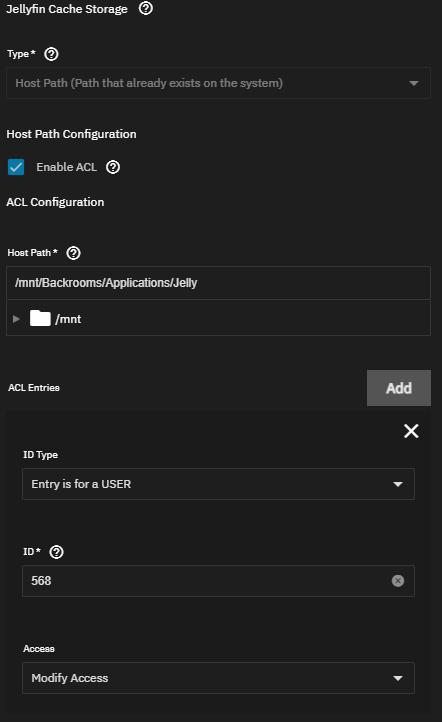

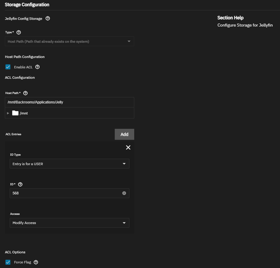

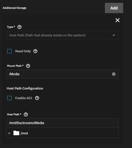

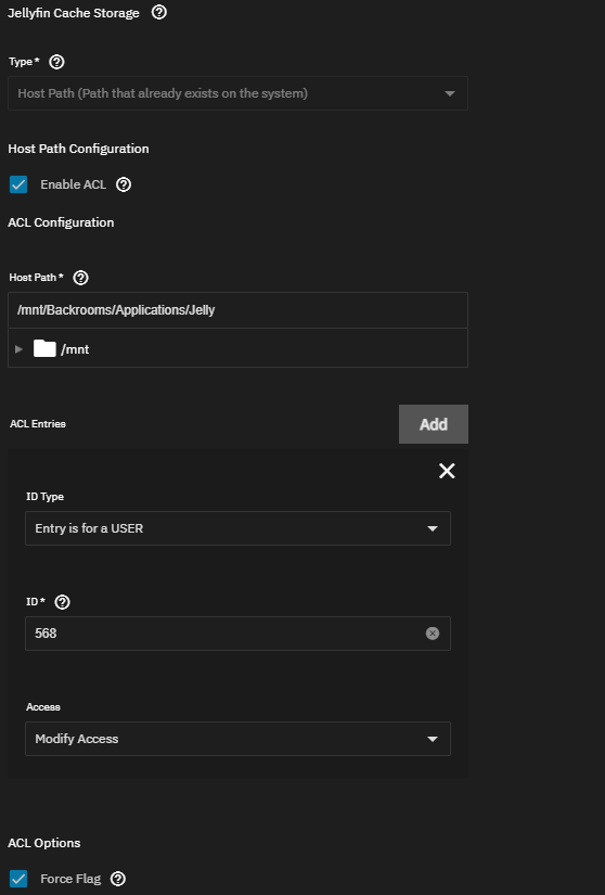

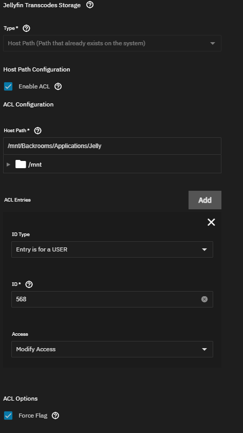

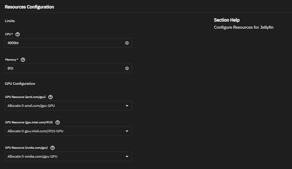

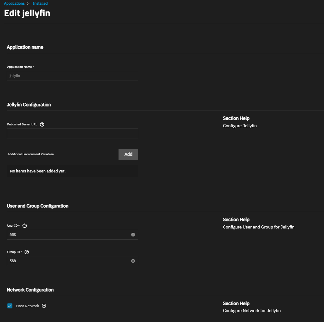

    In TrueNAS, can you share screenshots of your Jellyfin config page?
    And it looks like you haven't setup hardware acceleration yet. But first we need to fix the existing issue with /cache.
