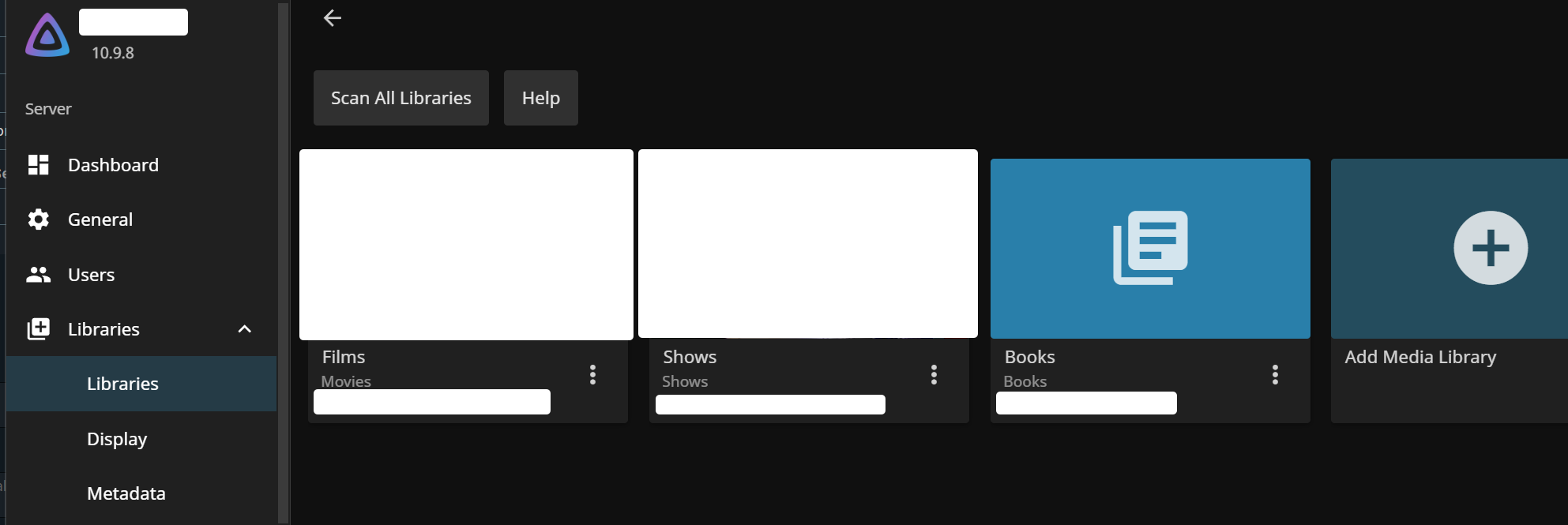

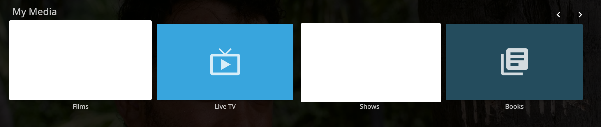

    I am having some issues removing the Live TV library after adding it.
    As you can see it is present on the homepage under My Media.
    but it is not listed under libraries and cannot be managed like a normal library.

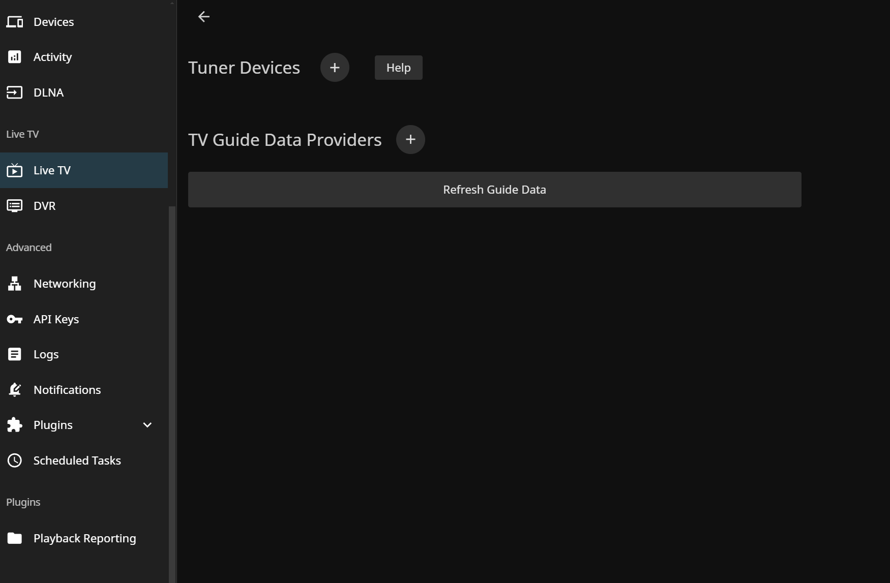

    Didn't see anything obvious under the Live TV specific settings, only options to setup tuner cards.

    Did you add any M3U tuners?  What is listed in Dashboard > LiveTV?
    unclebernard
    2024-09-05, 01:58 PM
    Yeah, no tuner devices setup under the Live TV Dashboard. Slightly-frowning-face

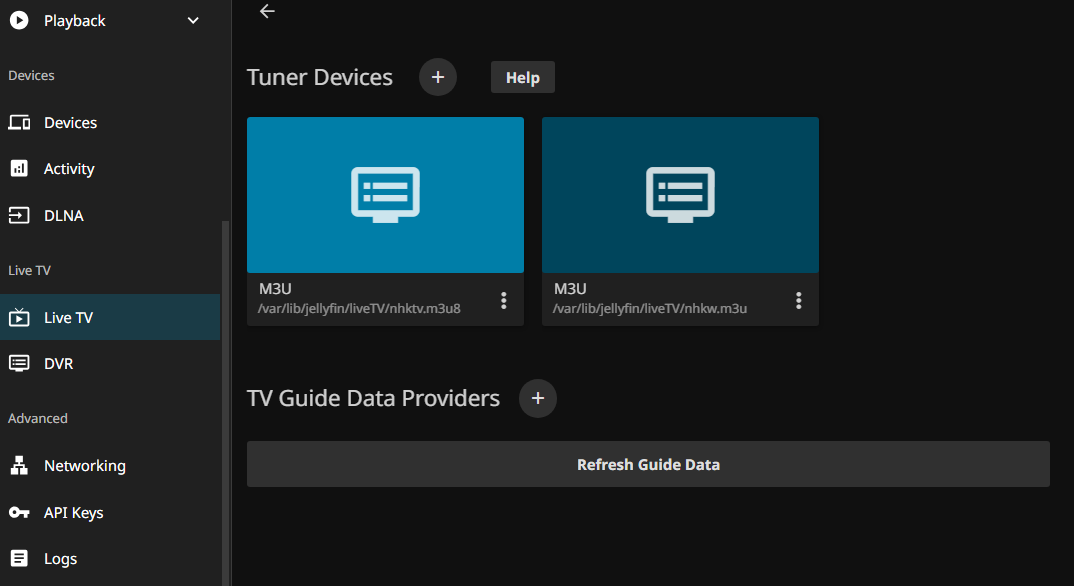

    I removed my M3U tuner on my test system and it removed the home screen LiveTV listing. So it definitely should be removing it.
