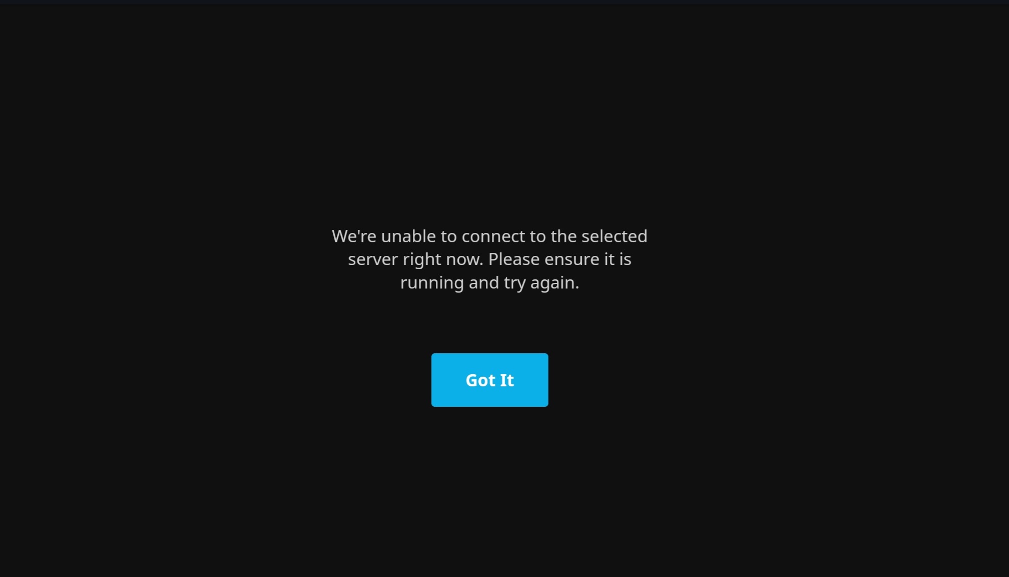

    I am running 10.9.0 build 2024040106 on Debian 12. The only reason I am running 10.9.0 is I wanted to use hardware transcoding and tone mapping on my AMD 5700g, which is not yet available on 10.8.x
    This setup has been working fine for the past few months (with an older build ofcourse). However over the last week I am having issues with the server. There were no config changes over the last few months.
    1. Scan media library is just stuck at 0.0% and the logs don't show any error or success message other wise. New media doesn't get scanned until I restart the whole machine
    2. Having playback and crashes.
    I have posted a few logs below. Hoping someone can help me debug the issues. timestamp of issues around [2024-04-07 15:52:15.659 +10:00] in the jellyfin log file.

    When i try to access the webUI i get the below error message (see attached image     ). asthough the server is not reachable. however ping and SSH works and checkings systemctl status jellyfin says that the service is running.
