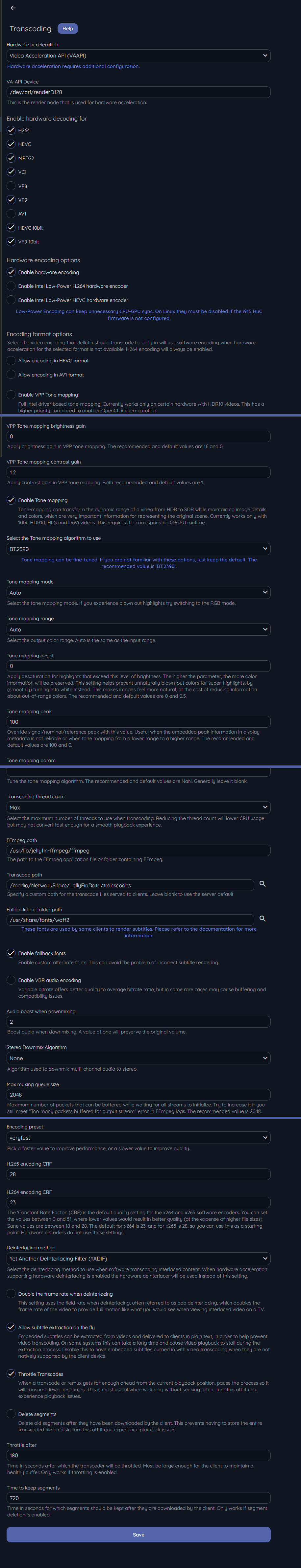

    Are you using Vulkan or VAAPI?
    Maybe0842
    2024-05-19, 08:25 PM
    I believe VAAPI. I've attached a screenshot of the transcoding settings page.
