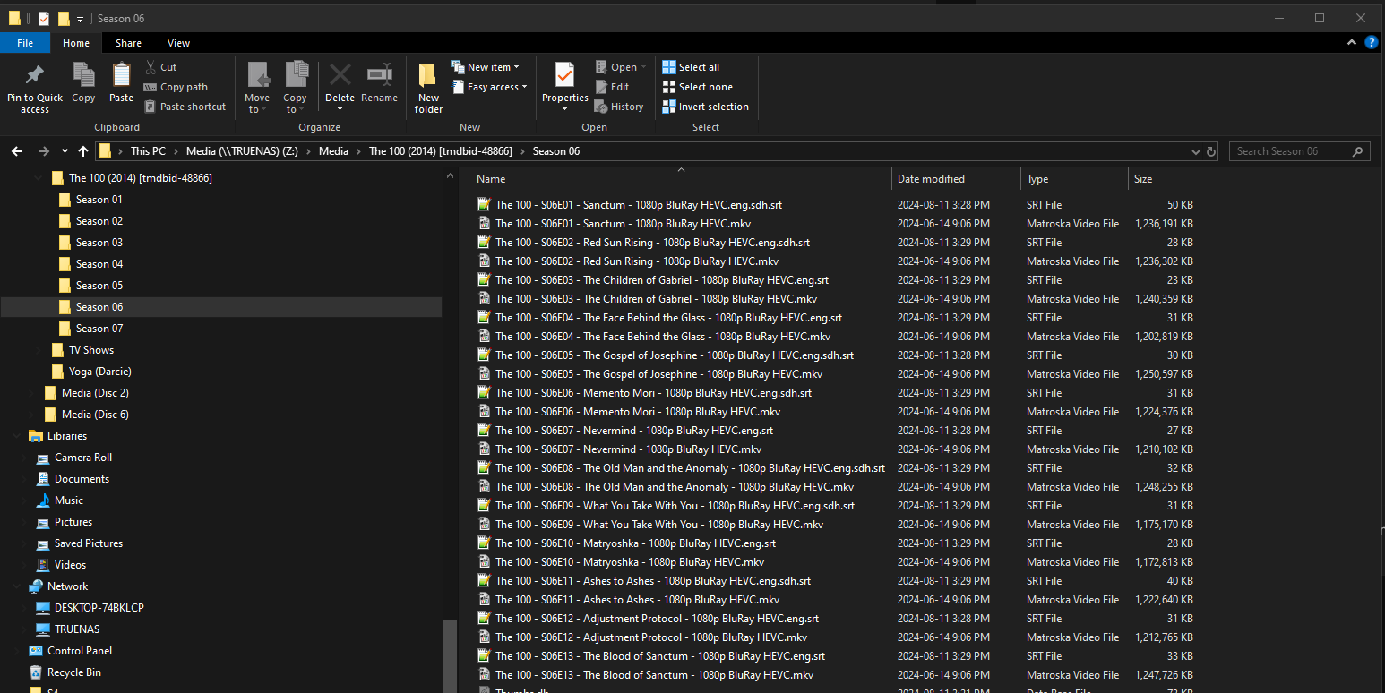

    The version of Jellyfin you are running 10.9.9
    Your installation method and platform:
    Platform: TRUENAS-MINI-3.0-X
    Version: TrueNAS-SCALE-23.10.2
    Source: TrueNAS Catalog
    Directory: The 100 (2014) [tmdbid-48866]
    Subdirectory: Season 01
    Subdirectory: Season 02
    Subdirectory: Season ...
    File: The 100 - S01E01 - Pilot - 1080p BluRay HEVC.mkv
    etc
    Jellyfin App on Windows 10 (not showing up in Infused on AppleTV either)

    I do have a library that is just TV. in the numbers there is no The 100, under then Ts there is no The 100.
    Desktop I can see it there in the directory tree. I SMB share over my stuff to the server.
    3 Body Problem, 11.22.63, 12 Monkeys, 13 Reasons Why etc all show up. This show does not.

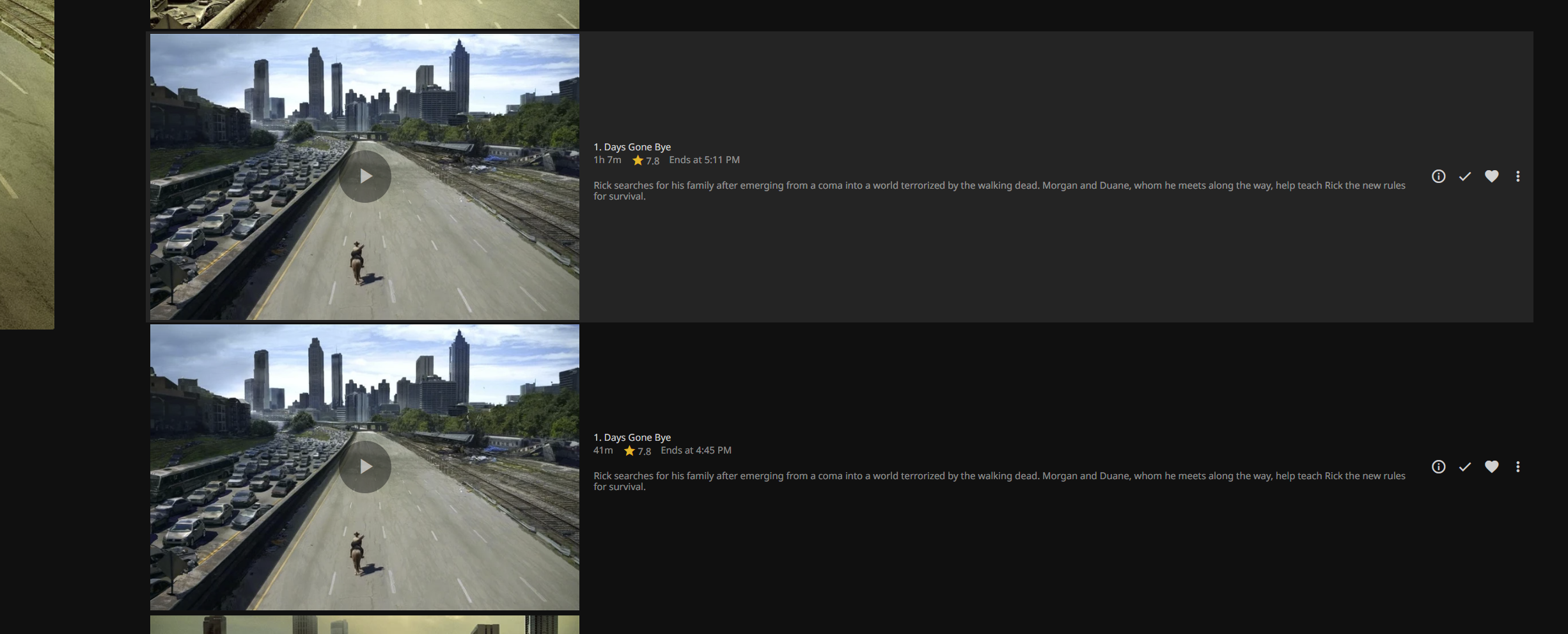

    Jellyfin has determined that it is yet again "The 100" is "The Walking Dead", and generally is having issues with that

    Ok, that clears up things even more. I didn't realize the show was identified as The Walking Dead. That's a great show, so no issues there ☺️.
    I initially tested with your file structure, and it came back as "The 100." I then noticed you’re using the TVDB plugin, so I re-ran the test with that plugin, and it identifies the show as The Walking Dead. So, it looks like there is a bug in that plugin.
    Here's a workaround: Follow the same steps as before, but before re-adding your media, change the TV shows library settings to prioritize the use of the TheMovieDb plugin as the metadata downloaders.
    Seems to have done the trick, I do wonder if I should delete all NFOs in case other shows have gotten lost in this fashion, but that's for another day.
    I do wonder if The Walking Dead has files that it thinks should be there, but I just don't have, or if I use to have them, but deleted them or renamed them (things like spoiler for upcoming episode list in red as Missing). Either way the episodes are there, and I'm not terribly sure how to do Extras and Featurettes. I had figured it out in Plex some time back, but my hope is to be fully switch over to Jellyfin.
