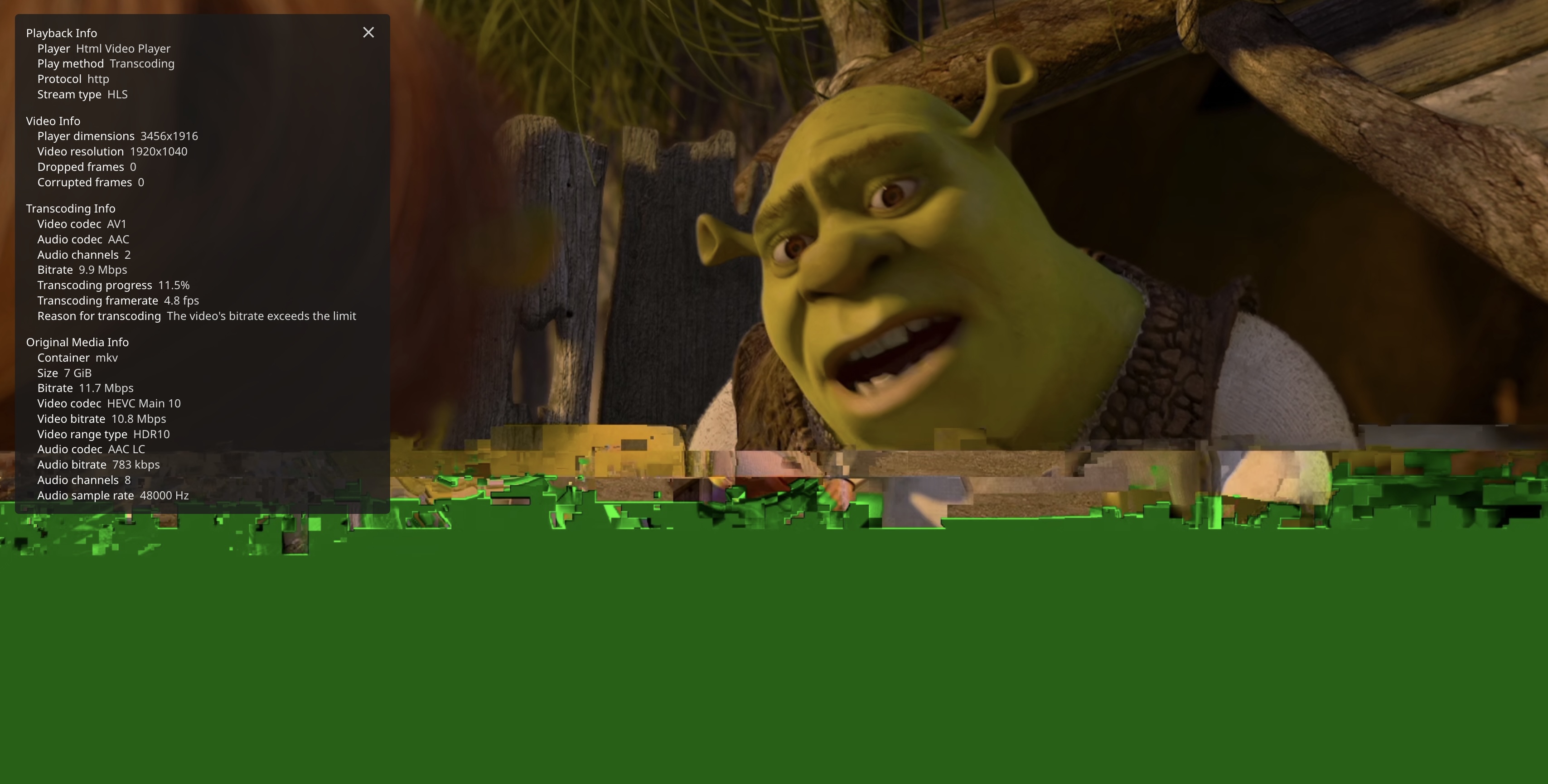

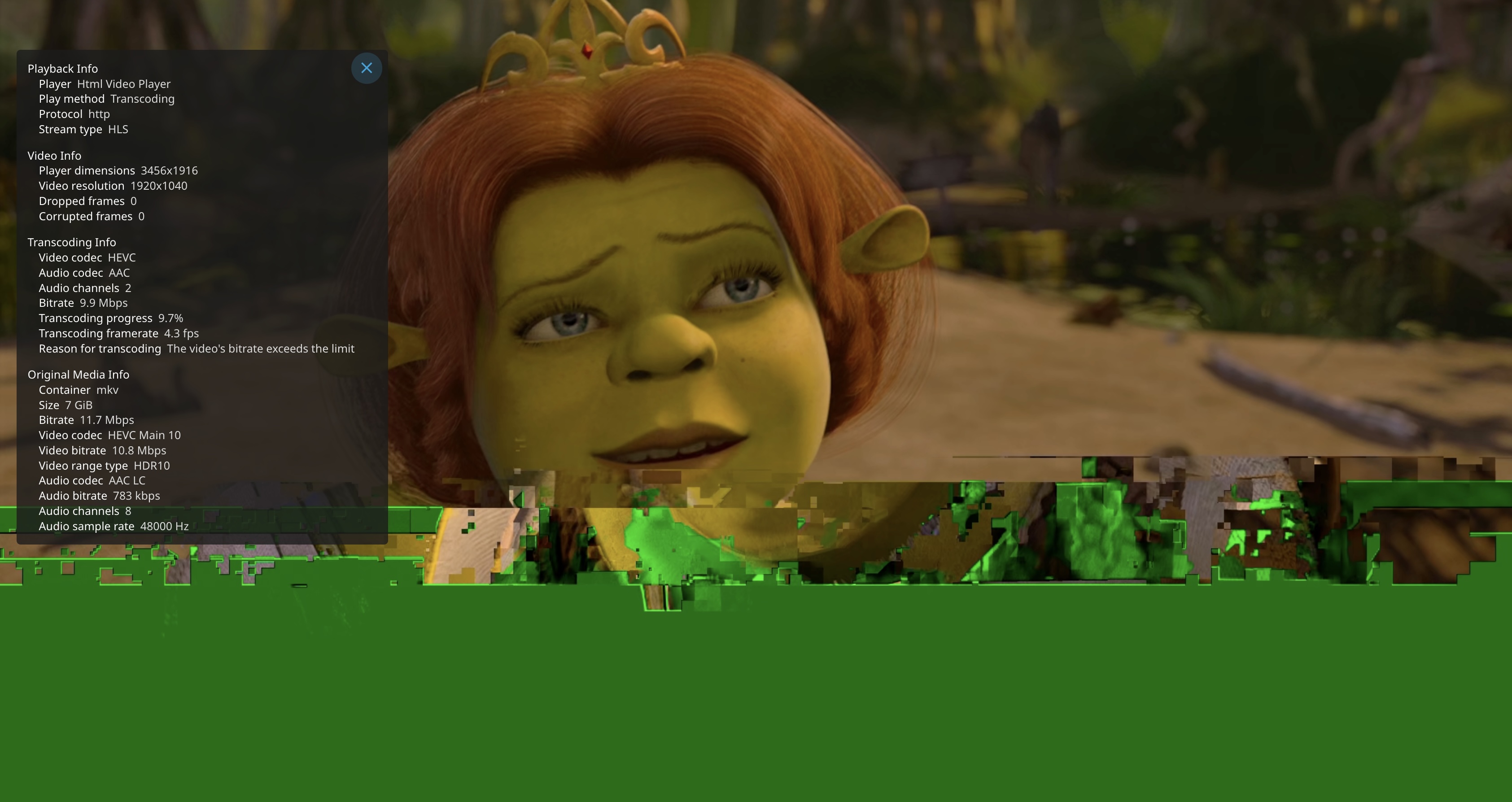

    I noticed this afternoon that the transcoding performance of Jellyfin is far worse than ever before. I am running Jellyfin in an Unraid Docker with an Arc A380 passed into the container for transcoding using VAAPI. When I trancode I see activity on the card. I've used the card for transcoding before and performance has been good and I've never experienced this issue before. I was even able to transcode and stream HDR content remotely using Tailscale without the transcoding fps being an issue. I didn't consciously change any settings prior to this happening, but I did update my Tailscale plugin on my Unraid server.

    Have you been transcoding before or has it been direct playing? The screenshots says the transcode reason is due to the bit rate exceeding some limit.

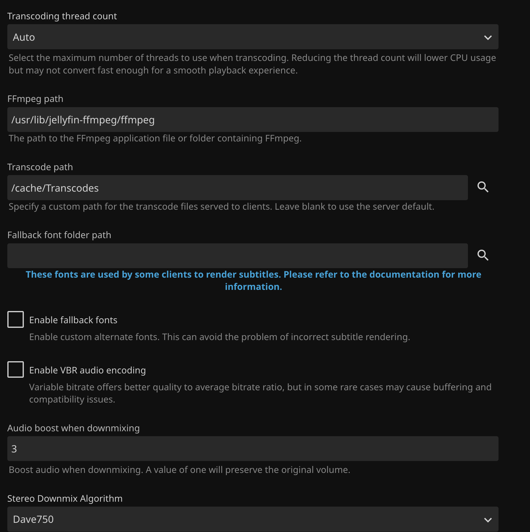

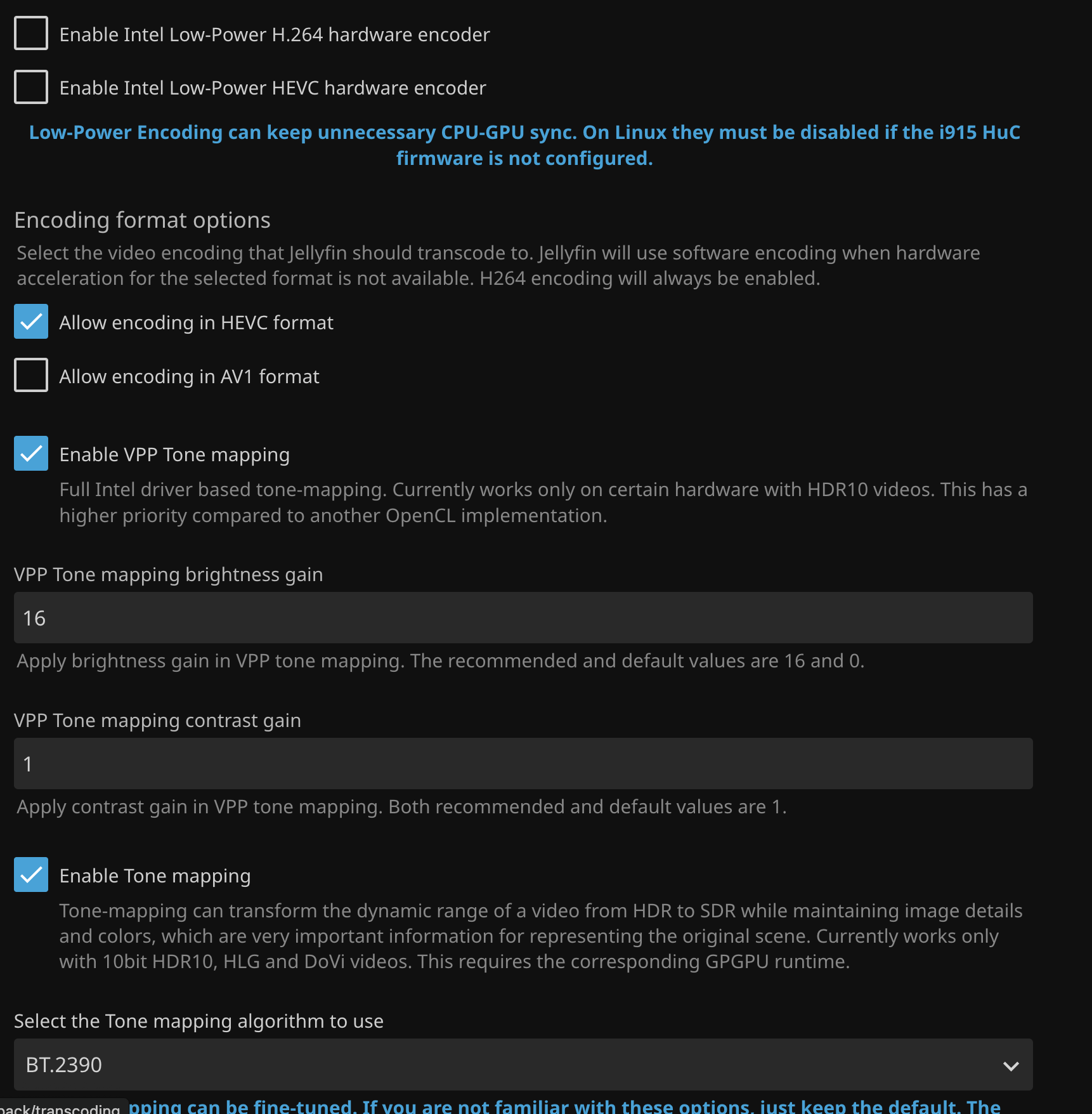

    Can you post a screenshot of the transcoding tab in jellyfin?

    2024-08-25, 04:54 PM (This post was last modified: 2024-08-25, 04:58 PM by yellowjacket_ur. Edited 1 time in total.)
    Here are screenshots of the Transcoding tab.

    Hm I'm not an Intel ARC expert, but I would expect selecting QSV whould be better supported than pure VAAPI.
    Also you sure your trancoding folder /cache/Transcodes is on reasonable fast storage?
