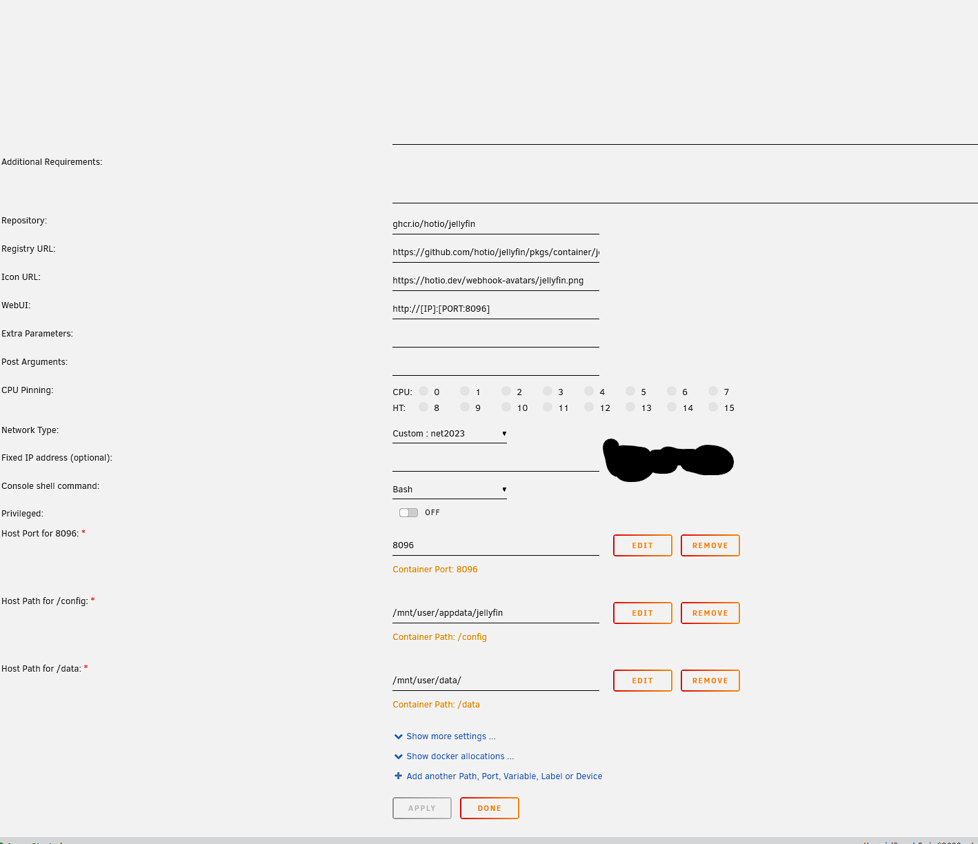

    I've installed the Unraid driver from Nvidia and attempted to modify the Jellyfin container parameters to use the Nvidia video card, but I'm not sure I've done it correctly.  I've attached a log file of a failed playback and a screenshot of the container parameters.  I'm new to Unraid, Jellyfin etc, I have probably missed something trivial so don't assume I set up permissions correctly etc.  Thanks!

    Thanks for the quick reply.  I tried the terminal command docker exec -it jellyfin nvidia-smi and it comes back with statistics on my video card.  I also changed the Nvidia-Visible_Devices to all from my specific card numbers.  It didn't correct playback.  The terminal command also produces statistics in that case so I think both could work.  I think everything else listed I had previously done.
    I suspect the issue is file permissions for the transcoding cache but I'm not sure.
