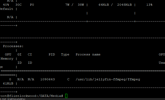

    nvidia-smi
    That will show you the GPU stats. But since you selected NVENC it won't try to use the CPU. If you selected NVENC but had an AMD GPU it would fail.

    2023-11-11, 01:11 AM (This post was last modified: 2023-11-11, 01:13 AM by jsnotlout1. Edited 2 times in total.)
    Ok
    How does this look
    Thank you SO much for all your help.
    2023-11-11, 02:52 AM
    That looks right. ffmpeg is using the GPU.
