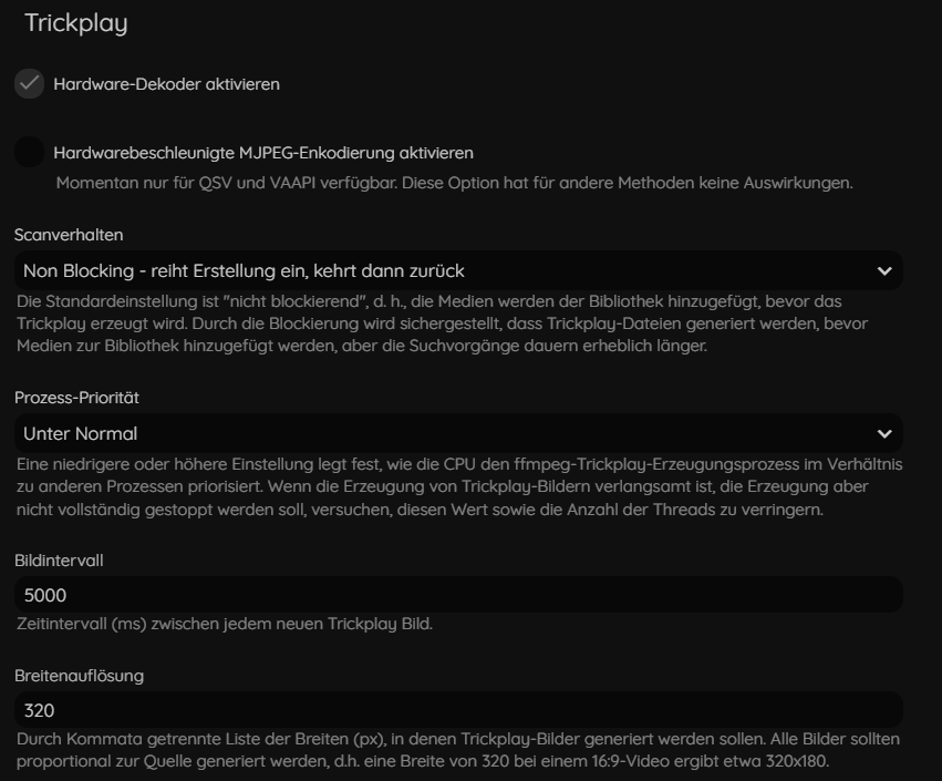

    i have an issue in 10.9.2 where i have enabled the Trickplay generation.
    I also ran the Task "Generate Trickplay Images", but i still only see Chapter Pictures.
    I have disabled the Jellyscrub Plugin, does this have to be enable in order for this to work?
    Screenshots Jellyfin Trickplay Settings & scrubbing preview
    Thank you guys!

    Hi, i just wanted to give a quick update.
    I've enabled the Jellyscrub Plugin again, it then told me to convert the bif files and remove those after the convertion.
    So i did, and the Trickplay was working fine then.
    Then i have uninstalled the Jellyscrub plugin again, and all Trickplay pictures were "gone" the trickplay frames are not displayed.
    After starting the Task "Generate Trickplay pictures" slowly the trickplay pictures came back.
    The task is now running since 3 days and slowly more and more trickplay pictures are coming back - lets see how long it takes to finish.
    But for now the Trickplay feature does work again.
    Thank you!
