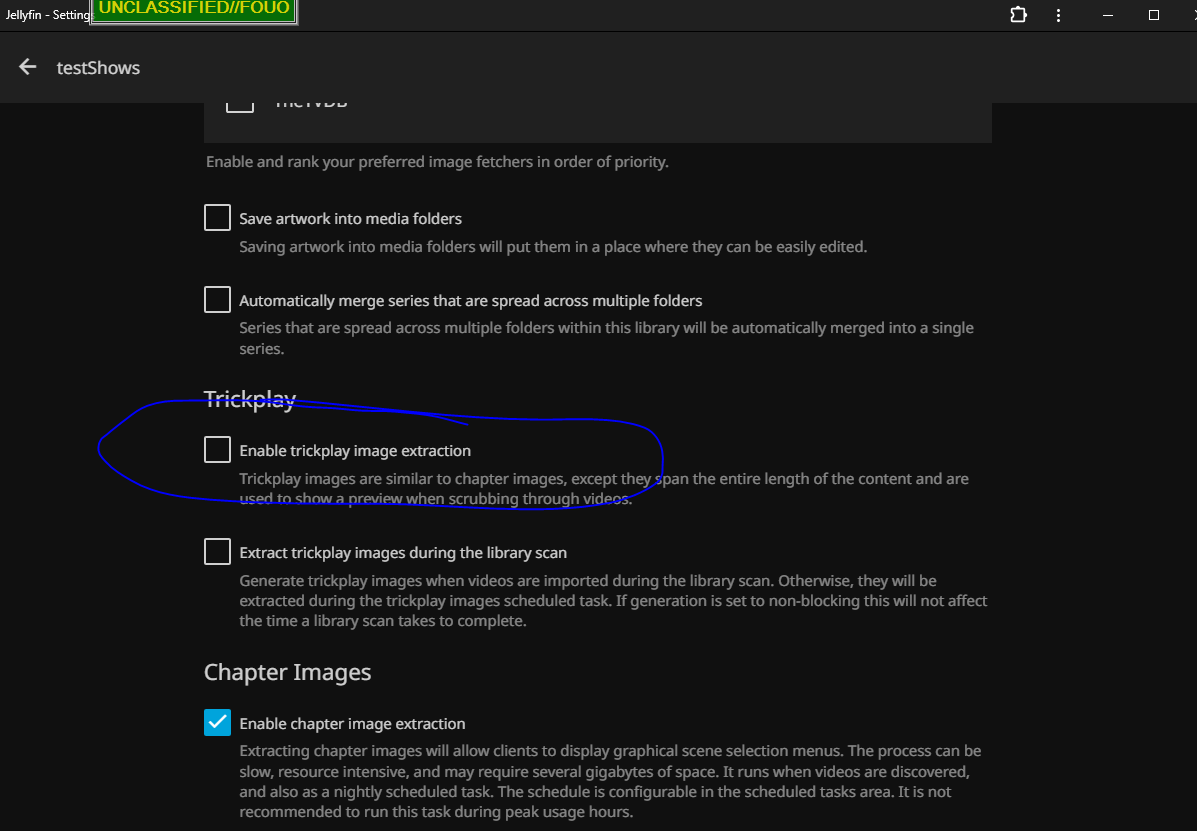

    Dashboard > Scheduled Tasks > Run Generate Trickplay Images job. What happens?

    Do you have Trickplays enabled in the library settings?

    (2024-06-07, 05:48 PM)TheDreadPirate Wrote: Dashboard > Scheduled Tasks > Run Generate Trickplay Images job.  What happens?
    It just runs and finishes.
    Here's the log report generated after I manually run the task.
    [22:05:34] [INF] [36] Emby.Server.Implementations.ScheduledTasks.TaskManager: Generate Trickplay Images Completed after 0 minute(s) and 0 seconds
    #14
    2024-06-07, 07:10 PM
    (2024-06-07, 07:06 PM)MisterMcDuck Wrote: Do you have Trickplays enabled in the library settings?
    Good point.  I forgot it isn't enabled by default.
    Ohhy veyyy, I didn't realize it was necessary to manually enable Trickplay for each library.
    Thank you so much! 🙏🙏
    Looks like now it's actually scanning my media and generating the Trickplay images.
    I'll test once the task finishes.
