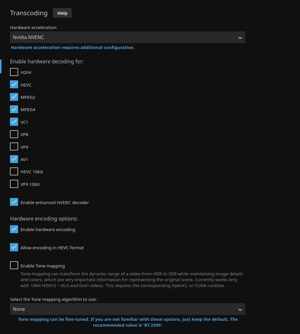

    Finally the JF playback screen is attached
    Thanks for any assistance and also for a strong, helpful community.

    2024-03-17, 10:44 PM
    Did you recently update the container toolkit or something? I wonder if you have to redo the configuration setup steps.

    2024-03-18, 05:50 PM
    Look at this Nvidia codec matrix and make sure you don't have any codec boxes chceked that your GPU can't decode. From your first post, definitely uncheck HEVC and uncheck "allow encoding in HEVC".

    2024-03-18, 10:05 PM
    That did it. Thank you for the help.
