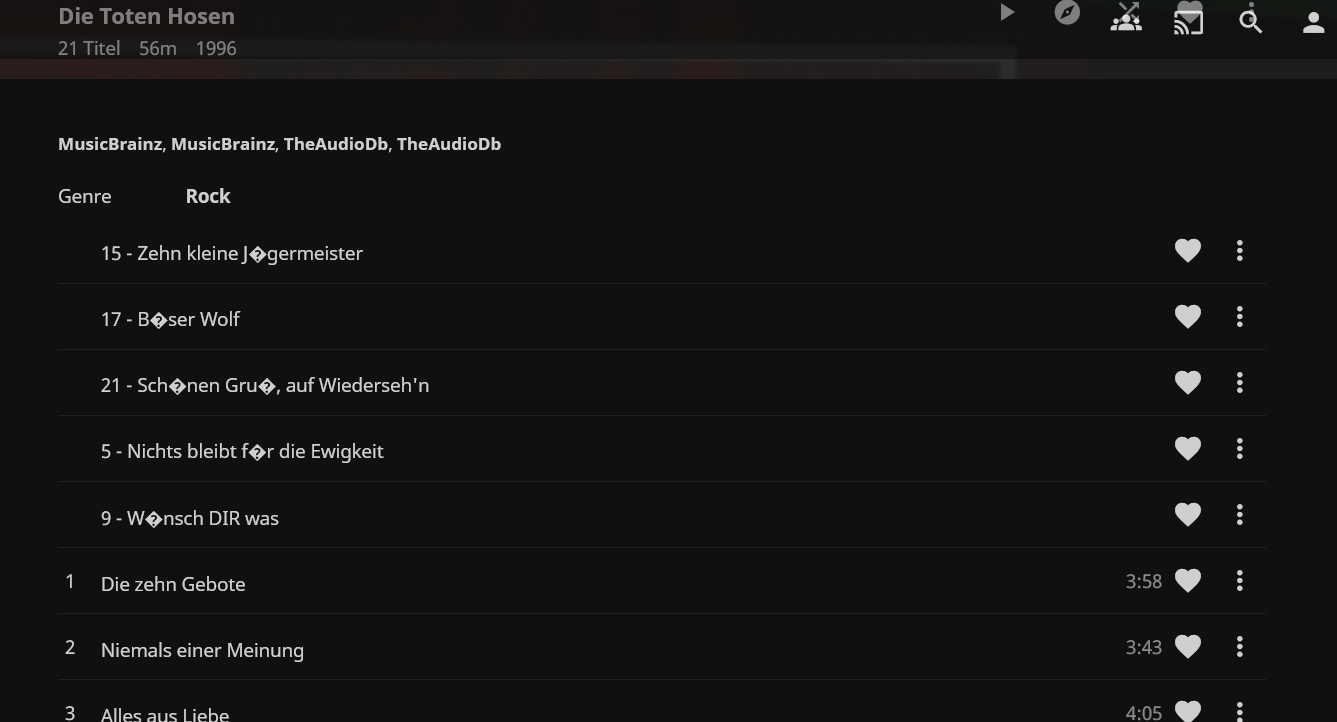

    As far as i can see are all files dedected except the one's with umlaut.
    The files with umlaut are listed in the Playlist but cannot played (pls see attachment), instead it shows an error message Like:
    Playback error
    This client is not compatible with the media and the server is not sending a compatible media format.
    Jellyfin runs in a Docker-Desktop (windows 10) Container (linuxserver/jellyfin) Vesion 10.8.10.
