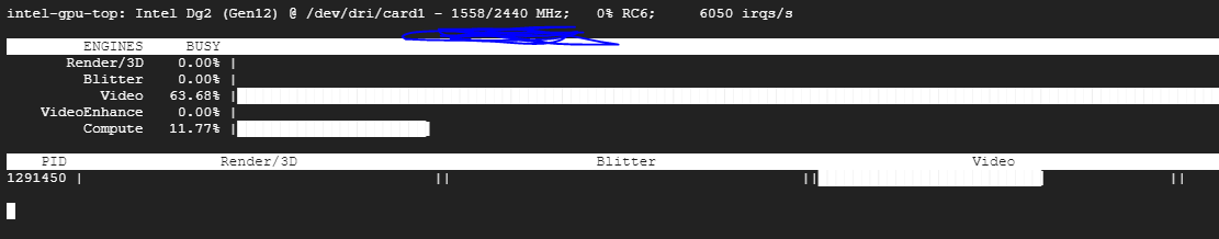

    seelk
    Posts: 19
    #28
    2024-09-12, 08:58 PM
    (2024-09-12, 08:15 PM)TheDreadPirate Wrote: Hmmmm.  The GPU initialization is fine.  HuC/GuC firmware loaded......
    Do you have intel-gpu-tools installed?
    sudo apt install intel-gpu-tools
    sudo intel_gpu_top
    While intel_gpu_top is running, initiate a transcode.  What is the core/memory frequency at?
    https://imgur.com/a/3DT2t0b
    Posts: 11,848
    #29
    2024-09-13, 02:23 AM
    I'm out of ideas.
    @nyanmisaka - Do you have any suggestions?
