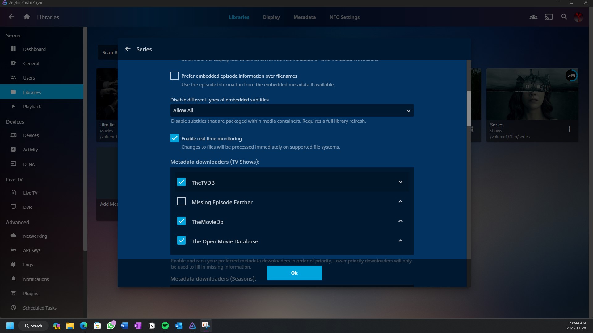

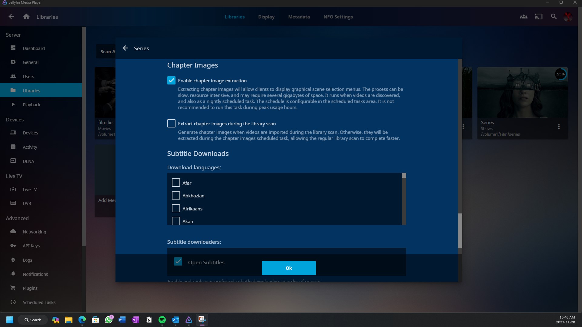

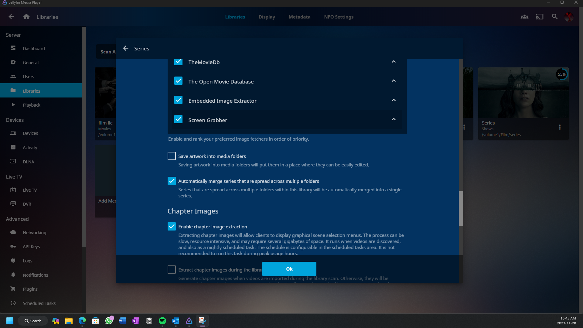

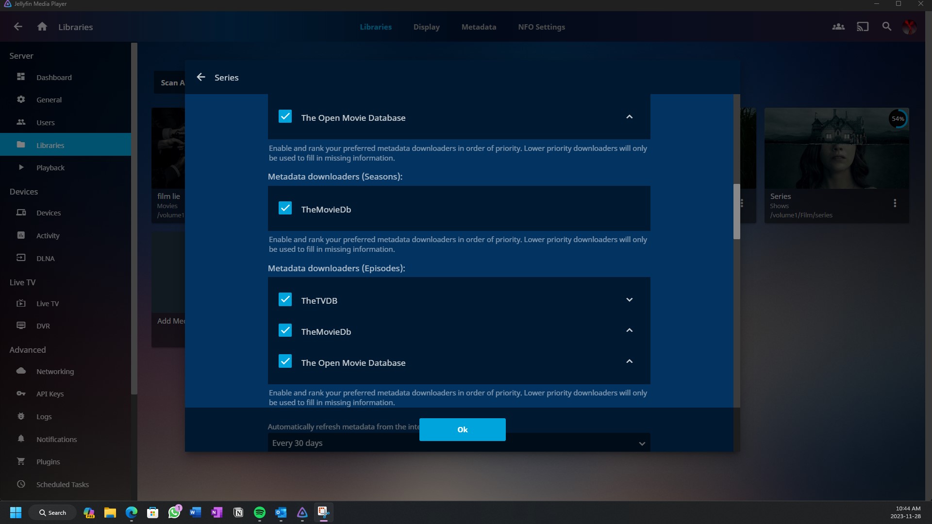

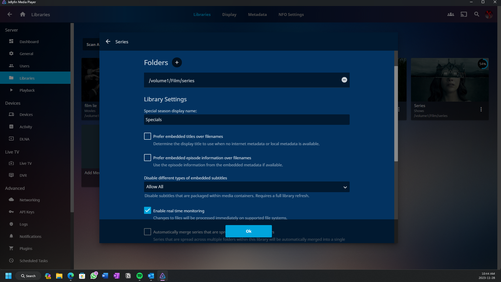

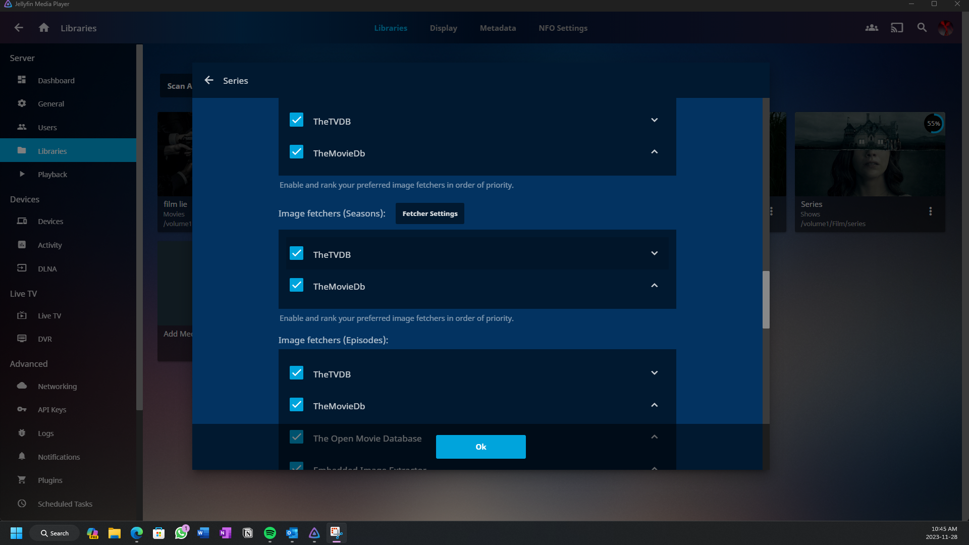

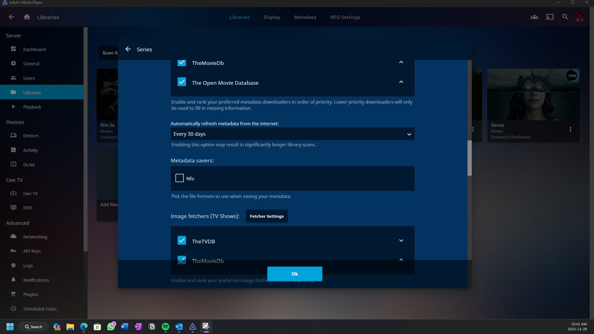

    (2023-11-28, 12:10 AM)tmsrxzar Wrote: did you enable "Missing Episode Fetcher" in your library config?
    where can i find this ?
    i can't seem to find the setting
    i went to "libraries -> the folder i need to enable it for -> it doesn't seem to be there (see screen captures)

    from the images above; top row, 3rd and 4th from the left "Missing Episode Fetcher" under downloaders

    (2023-11-28, 03:56 PM)tmsrxzar Wrote: from the images above; top row, 3rd and 4th from the left "Missing Episode Fetcher" under downloaders
    i tried that, it was a plugin, but it said it was unsuported and didn't work xd

    2023-11-28, 05:26 PM (This post was last modified: 2023-11-28, 05:27 PM by C2gl.)
    Alright xd
    im stupid
    even tho its marked as unsuported, activating it solved the issue
    so for everyone encountering this in the future, here it is to sum it up
    downloud the plugin for the TVDB and do not modify the per default API
    download the "download missing eppisode" plugin
    set the TVDB plugin as your number one source for the metadata fetchers and the "missing eppisode" as second priority
    and then, if you do this in an already excisting library, force replace all excisting metadata, and that did the trick for me
