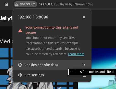

    Did you try clear your browser cache first>
    2024-09-11, 01:11 PM
    You can also do ctrl+f5 to fully refresh.  If you don't want to clear your entire browser's cache, you can just clear Jellyfin's cache.
