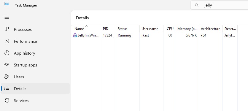

    I added a screen capture to the original post. I don't see anything under services. I see 4 things under "Startup Apps" for Jellyfin - but I don't see anything duplicated. Am I looking in the right place?

    Try look at the Details Tab and look for instances of jellyfin server

    OK. Thanks for trying to help me with this. I rebooted the PC to get through the whole process.
    PC starts. JellyFin Tray Icon appears.
    Error - jellyfin.exe has stopped working (see screenshot SC1)
    Task Manager DETAILS shows only one JellyFin running (see screenshot SC2)
    Task Manager PROCESSES shows only one Jellyfin running (see screenshot SC3)
    Task Manager STARTUP APPS shows four items, no duplicates (see screenshot SC4)
    System Tray only shows one instance of Jellyfin running (see screenshot sc5)
    Right click the tray icon and exit. Restart from desktop icon and now everything works perfectly.
    2023-08-22, 04:27 PM
    I'm assuming "rkast" is your user? Which tells me this is running as a user startup application.
