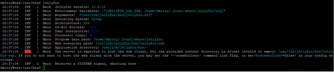

    hello everyone, I understand the error is already known, but everything that I found did not help me solve it after starting the service, it takes just a couple of minutes, and the service stops working only if you run it directly from the console.
    Method with the command ln -s /usr/share/jellyfin/web /usr/lib/jellyfin/bin/jellyfin-web does not work Upside-down-face

    If the web-app files are located at "/usr/lib/jellyfin/bin/jellyfin-web" then the correct commandline is:
    ./jellyfin --webdir="/usr/lib/jellyfin/bin/jellyfin-web"
    or you set an enviorment variable
    SET JELLYFIN_WEB_DIR="/usr/lib/jellyfin/bin/jellyfin-web"
    as documented here:
    Configuration | Jellyfin
    typos are finders, keepers.
    2023-11-22, 01:47 PM
    Do not run jellyfin manually. Running it manually requires that you specify a bunch of variables, which you didn't do, including where jellyfin-web is located. Just start the service. It will handle all of that. Kill the jellyfin process you started then.
    sudo systemctl start jellyfin

    I try it this way and the service shuts down a second after checking
    Let's start everything in order tell me how to completely remove with all configs and put it right jellyfin, maybe I've already broken everything, please tell me.
