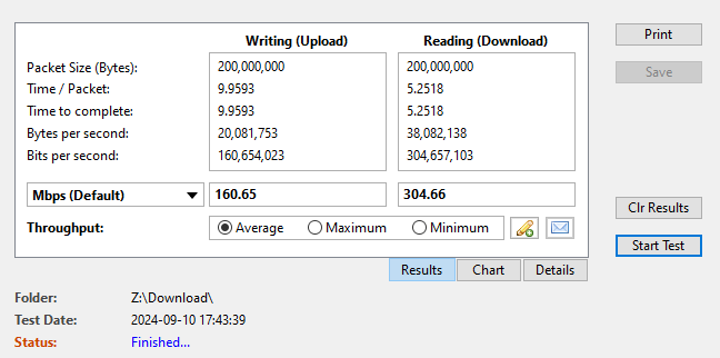

    So my setup used to work fine, however not so much anymore. Slight stutter when playback 4k movies, I have my server installed onto my desktop and playback to my Nvidia Shield, so no transcoding should be happening. Eventually want to setup a NAS and go that way but need to iron out these issues first.
    Desktop specs:
    11700k
    3070ti
    32gb Ram
    Shield I have to use a usb to ethernet adapter due to the port blowing up in a storm. I Have done a Lan read and write test to the drive (not sure if this effects network transfer over jellyfin) but I know I get quicker then my 60Mbps movie so I dont see the network as a bottleneck.
    Any help much appreciated.
