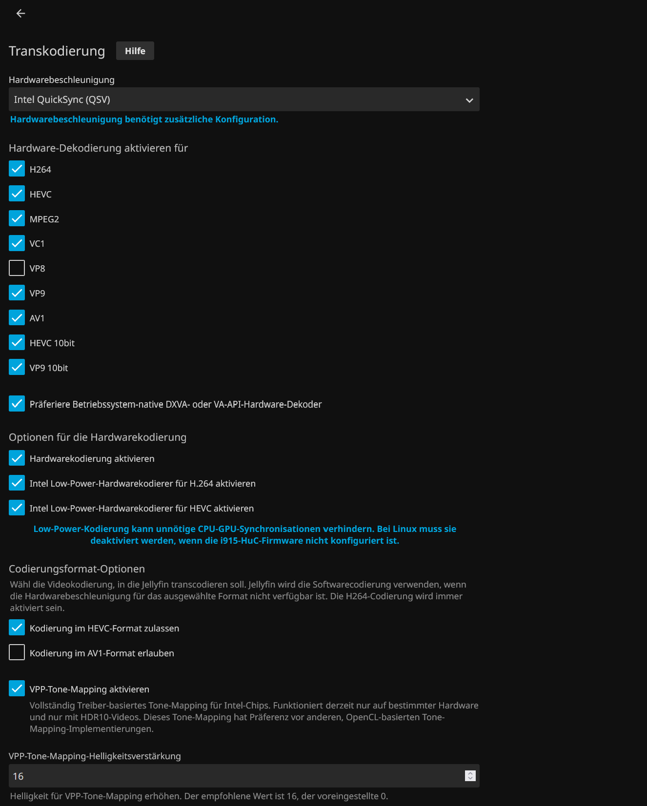

    You can check ALL of the codecs in the list EXCEPT VP8. And you need to uncheck AV1 ENCODING (Allow encoding in AV1 format).
    Can you attach the log from after you've checked HEVC 10-bit?

    i changed it to thesettings you advised
    but still stuttering
    i attached the log after the changes
