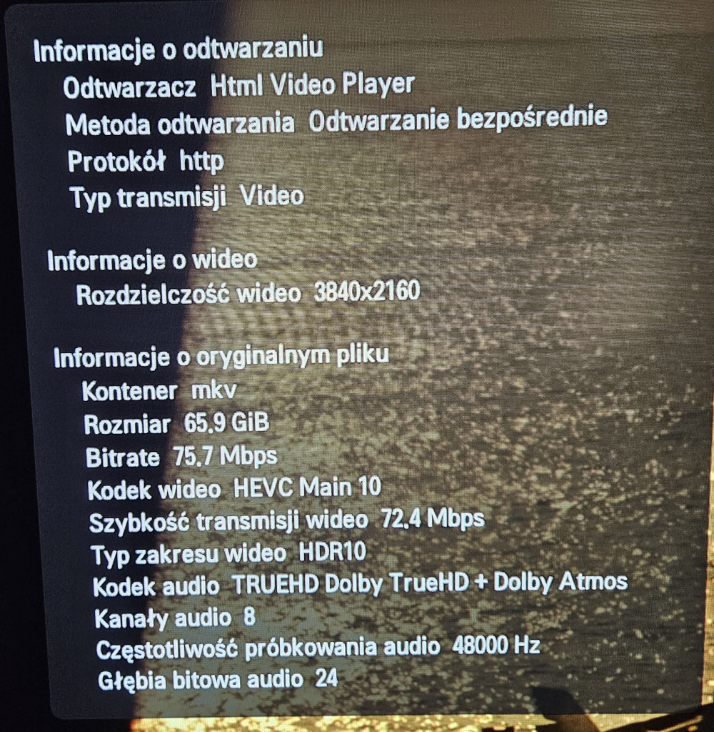

    playback settings:
    playback info: # edit: sorry for non-english language

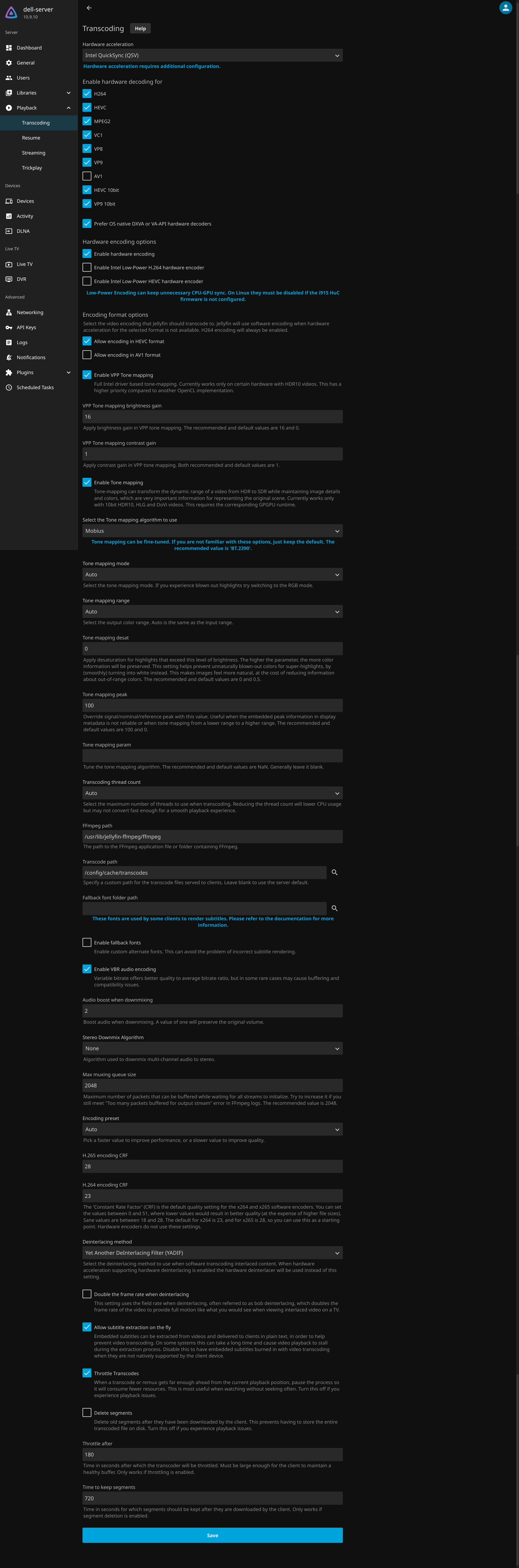

    I tried a few things like changing transcoding settings but it lags even when direct play if I am not mistaken. Any ideas how to troubleshoot this more? Some things don't work on my tv app (other audio than true hd, speeding up) on some files so could not test them.
