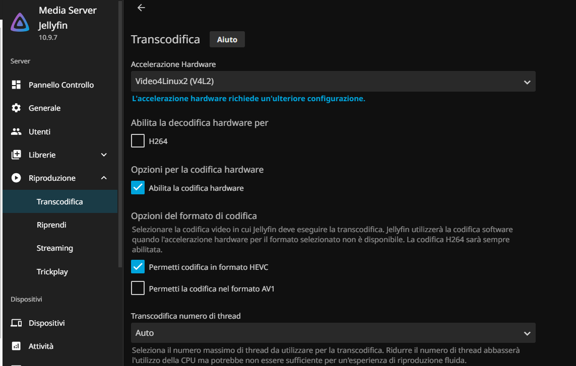

    2024-08-29, 03:30 PM
    (2024-08-29, 10:11 AM)Luke64 Wrote: You don't have to burn in the subs to all of your videos. That's what transcoding is for. The subs should get burned into the video if they're not supported on the ATV app by default (unless you disabled transcoding permissions which seems like you did).
    where do I check that transcoding is disabled for subtitles? ... I don't think I disabled it!
    Thanks

    2024-08-29, 03:45 PM (This post was last modified: 2024-08-29, 03:45 PM by TheDreadPirate.)
    The RPi4 does not support HEVC encoding. AFAIK, it only supports 1080P H264 encoding. But even that may not work.
    If you already had it setup this way, it was may have been failing when attempting to transcode.
    If you share your logs via pastebin, we would be able to make that determination.
