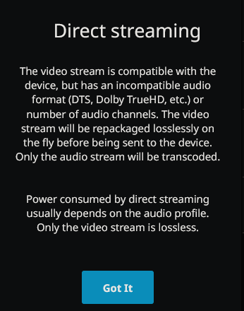

    I have tried it in VLC and can confirm that the video is not corrupted
    It says that the audio needs transcoded but the video will be repackaged lossless but it breaks when viewing it.
    version 10.9.11
    Ubuntu server 24.04.1
    FFmepg log
    To add this is happening on the roku jellyfin and android jellyfin clients
