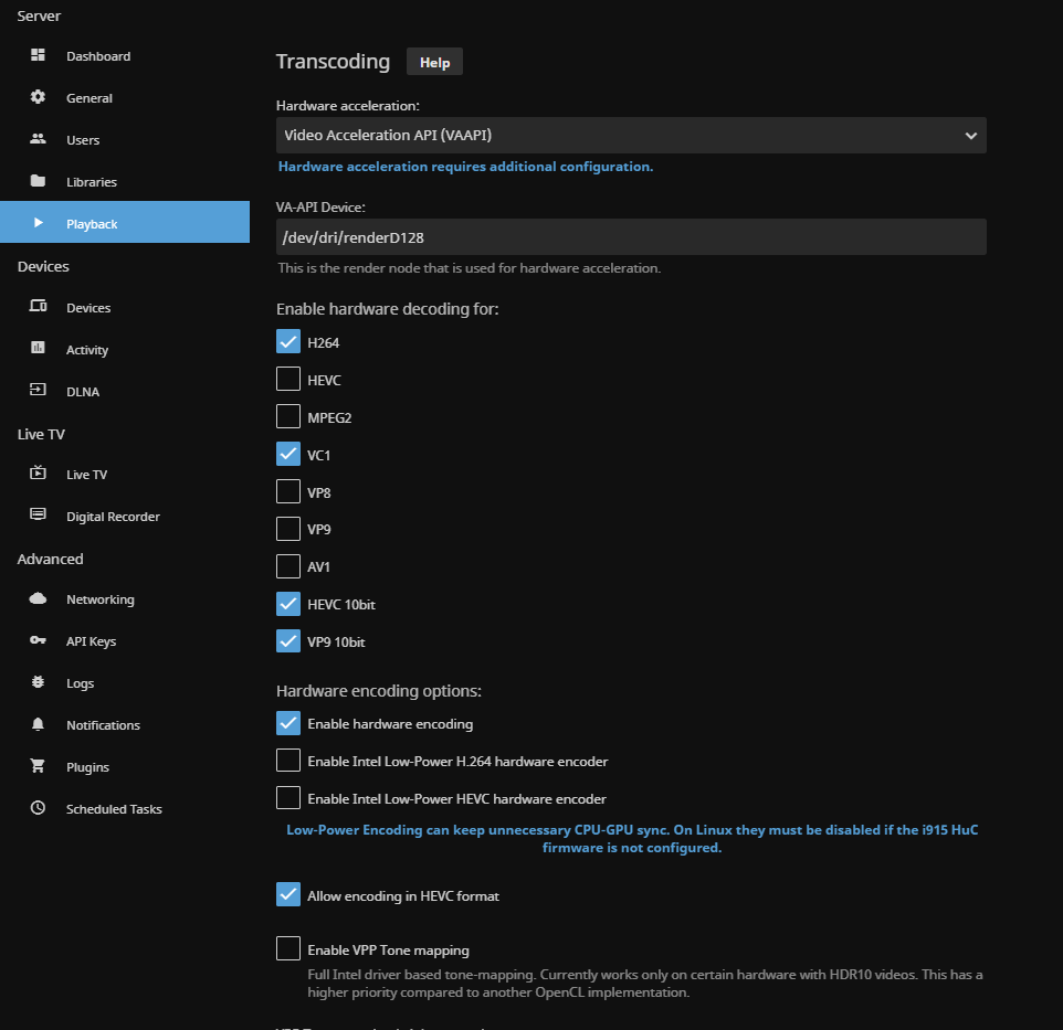

    I have a problem with transcoding video on my NAS. I installed application from https://github.com/pdulvp.
    My setting in Jallyfin (please see attachments). I turned video card on qts mode.
    logs files is in attachment (log.txt is for ffmpeg)
    My hardware:
    QNAP TS-673A with Nvidia GTX 1050 Ti
    please help me to turn on hardware transcoding on my QNAP.
    .txt   Log.txt (Size: 9.85 KB / Downloads: 38)
    2024-04-20, 09:46 PM
    Read this github issue. You need to install some additional package in your QNAP. And you should be using NVENC instead of VAAPI.
    https://github.com/jellyfin/jellyfin/issues/9806
