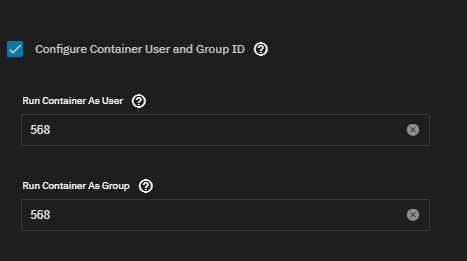

    And that was done inside the Jellyfin container? Looking over the screenshots you provided, I don't see a way to pass in the GID for the render group from the host.

    Deegee88
    Posts: 49
    Joined: 2023 Dec
    #27
    2024-03-13, 10:16 PM
    This is the only thing i can see that has anything to do with Groups.
    Jellyfin 10.9.4
    Ubuntu Desktop LTS 24.04
    Intel Xeon E5-1650 v3
    64GB DDR4
    Posts: 11,848
    #28
    2024-03-13, 10:20 PM
    https://www.truenas.com/docs/scale/scale...psscreens/
    So there is a separate groups screen. Add the render group if it isn't there. Then add UID 568 as a member?
    Deegee88
    Posts: 49
    Joined: 2023 Dec
    #29
    2024-03-13, 10:24 PM
    Okay i've added 568 (apps) to the group called Render.
    Do I have to change the group ID within the container from 568 to render?
    Jellyfin 10.9.4
    64GB DDR4
    Posts: 11,848
    #30
    2024-03-13, 10:31 PM
    No. That should stay as is. My understanding is that UID 568 being in the render group should be the equivalent of "group_add" in a plain docker setup.
