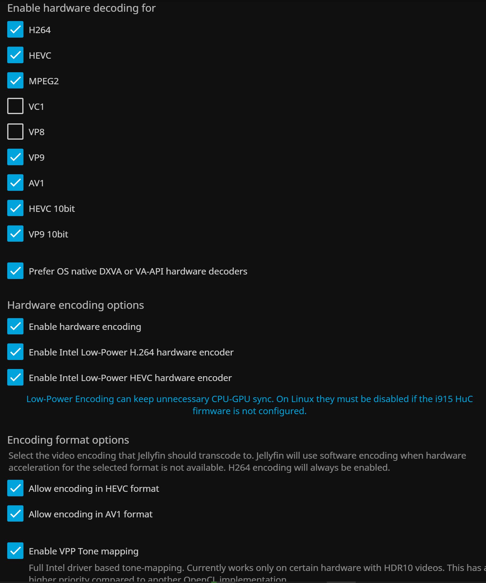

    After reading a lot of documentation on hardware transcoding, I'm wondering if I have my A310 setup correctly. This is my first "homelab project" for video files and transcoding. I'm sure there are a handful of Ubuntu cli commands that I could run to make sure I'm setup and working correctly.  Not sure if I know all of them. This is how I have the Jellyfin gui setup:
    (The top of the screen grab was chopped off. I have it set for Intel Quicksync (QSV))
    What else should I be looking at?
    Jellyfin 10.10.3 (bare metal), Ubuntu 24.04.1 LTS 6.8.0-49-generic (bare metal)

    2024-10-17, 04:20 PM
    That is all there is to it. Just make sure you have the intel-opencl-icd package installed. The linux-firmware package should already be installed (required for low power encoding, which is required for H264/HEVC on Arc).

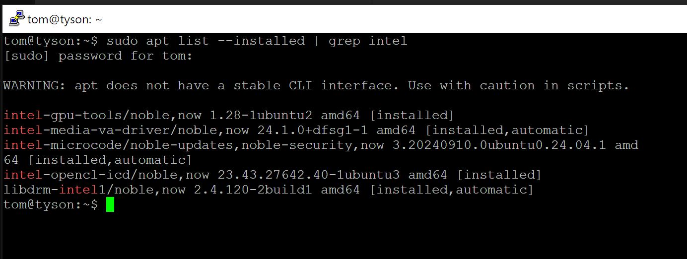

    (2024-10-17, 04:20 PM)TheDreadPirate Wrote: That is all there is to it.  Just make sure you have the intel-opencl-icd package installed.  The linux-firmware package should already be installed (required for low power encoding, which is required for H264/HEVC on Arc).
    Is there a cli command to show if the intel-open-icd package is installed and working? (sorry, still a linux noob)

    2024-10-17, 04:28 PM
    sudo apt list --installed | grep intel
    intel-opencl-icd is the package name.
    Thank you. Looks like I'm good to go then. Should I be worried about the warning message?

    2024-10-17, 05:12 PM
    No. That is normal. Something something, apt is really old, something something, doesn't like being piped into other commands. I've yet to see apt break when I pipe it into a grep.
