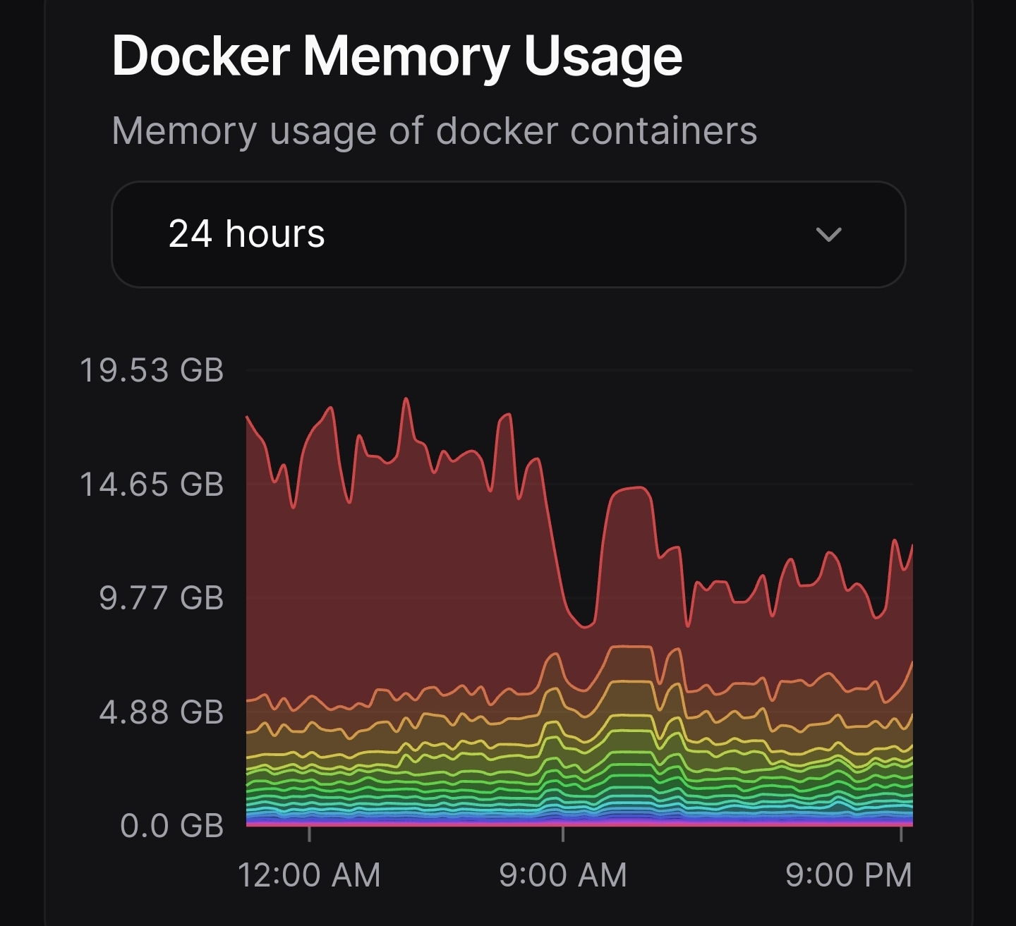

    #15
    2024-07-27, 02:28 AM
    (2024-07-26, 08:23 PM)TheDreadPirate Wrote: If you've restarted the container, it may not be there anymore.  How does your memory usage look after adding MALLOC variable?
    See attached. Looks better.
