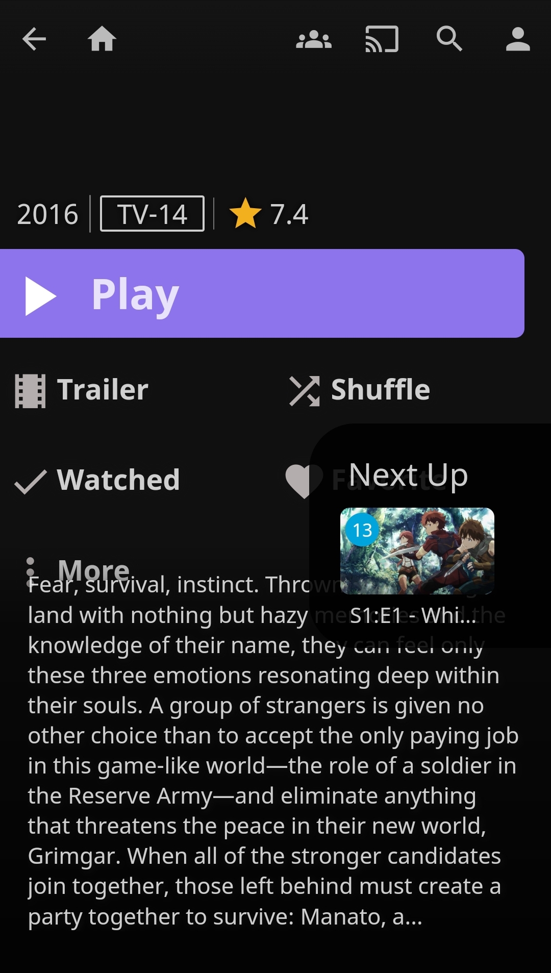

    New user to jellyfin here. Everything set up and working, I started using the android app and it has overlapping icons (see picture). The "next up" goes wherever it wants, covering up buttons occasionally, but the more (3 dots) is always mostly covered up by the description, and is nearly impossible to tap. My guess is it has something to do with scaling, but no clue. Any way to fix it?

    You are using custom css. This is almost certainly the cause of this issue. 😉

    does it look appropriate in landscape perhaps?
    not sure jellyfin lends itself to portrait mode very well, with or without custom css being involved

    (2023-11-30, 02:31 PM)thornbill Wrote: You are using custom css. This is almost certainly the cause of this issue. 😉
    Yep, that was it. Turns out the skin that I had chosen (jellytheme) from skin manager was causing it. I tried a few other skins that I liked, but all of the others that I liked the look of ended up having issues as well. Thank you kindly haha. Im hijacking the issue a bit, but I have another question. With the windows app, I am not able to skip forward or backwards into content while watching videos, but on the web player I have no issues. If I try to skip forward in the app, it kicks me back to where I was. Not sure whats up with that, and am wondering if there is any fix? Its difficult to look up this issue sorry haha. Might need to start a new topic for this one.
