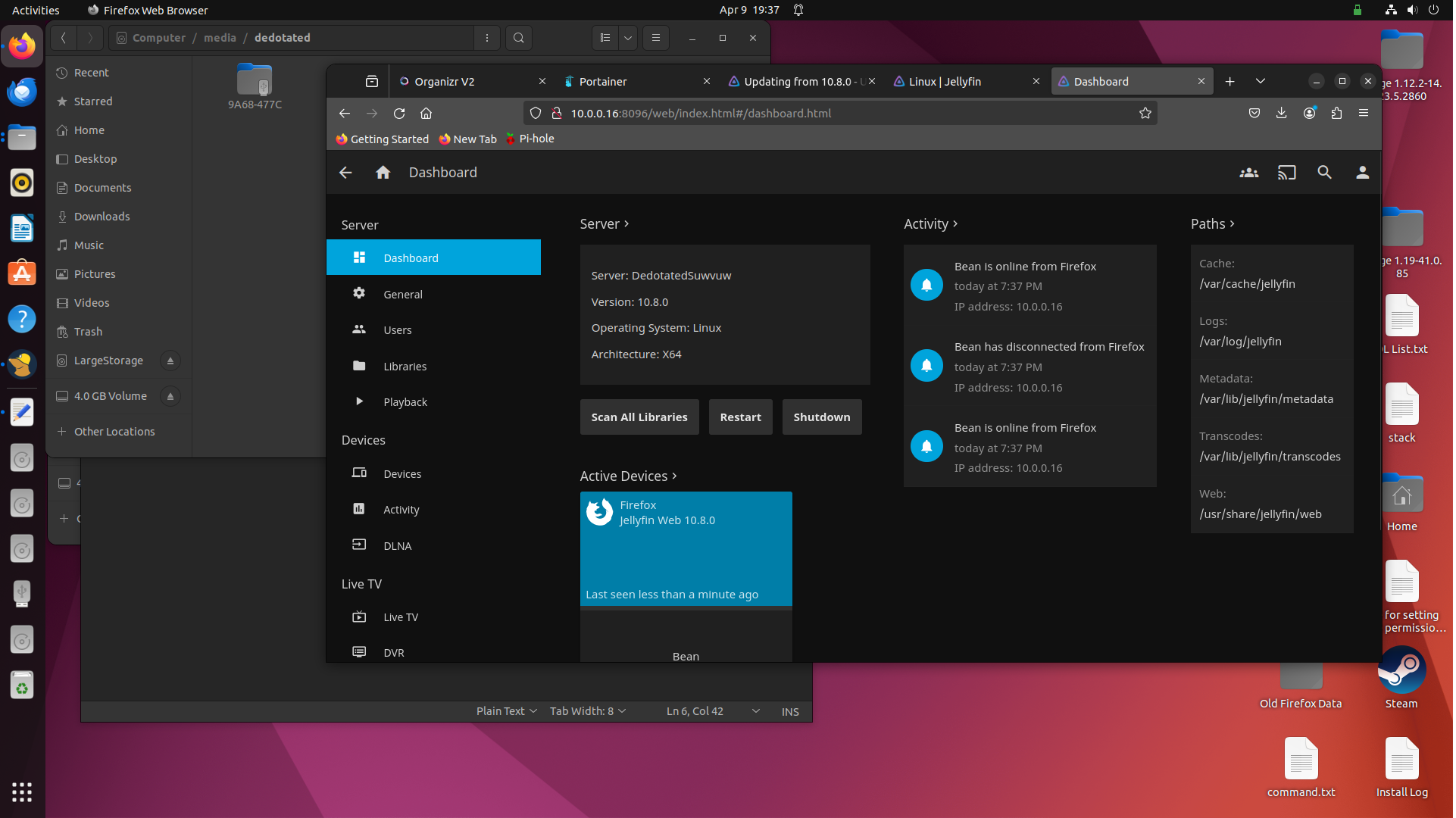

    2024-04-10, 12:02 AM (This post was last modified: 2024-04-10, 01:28 PM by DeckardTBechard. Edited 1 time in total.)
    I am on Ubuntu Jammy 22.04.4
    I ended up uninstalling;
    "sudo apt-get remove –auto-remove jellyfin"
    I didn't purge any config files
    Re-installed and added the repo manually
    Attached are screenshots after the re-installation of jellyfin.sources (I think they are correct. I didn't change anything, only checked it.)and the Dashboard in browser after clearing the browser cache.
    Stupid question.
    Is it possible I could have installed it twice on the same drive, just maybe different directories? Maybe I've been deleting and re-installing to the default locations, but the one I'm actively using isn't the same one? Is there a way to check this?
