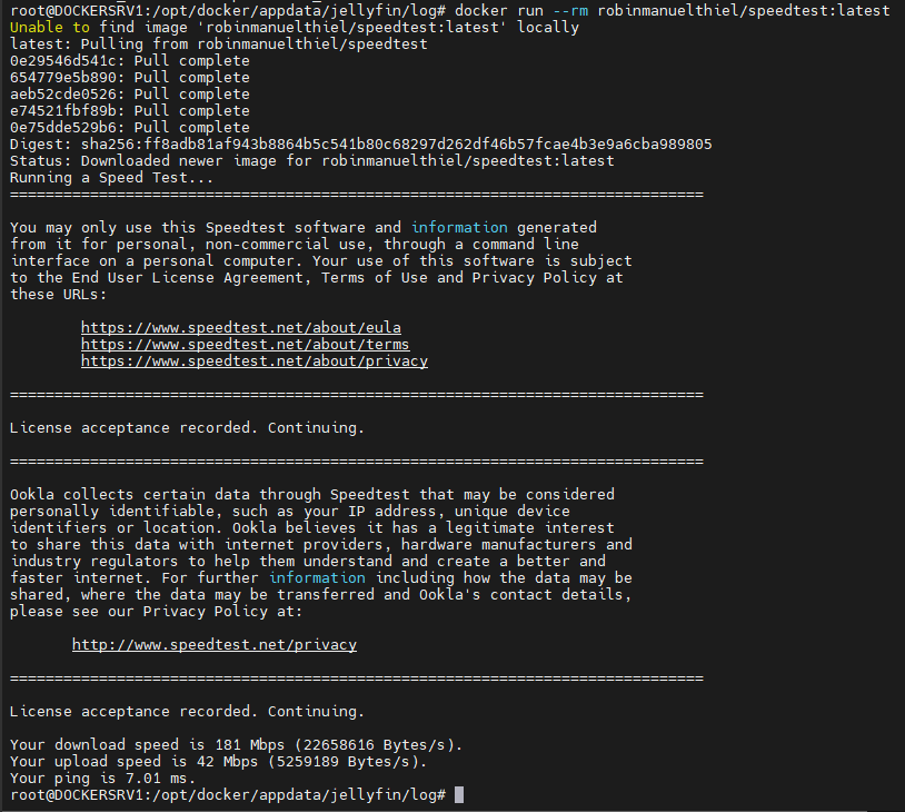

    2024-03-18, 10:41 PM (This post was last modified: 2024-03-18, 10:44 PM by Unkn0wnUs3r.)
    No, my clients are a few kilometers away, streaming with different devices like apple ipad or webbrowser from my domain media.unknownworkspace.de.
    At home, i also stream from my domain - which is kinda useless because the traffic will also go through the www.
    Cant find any options regarding nat loopback in either my firewall nor my router.
    Speedtest inside an extra docker container.
