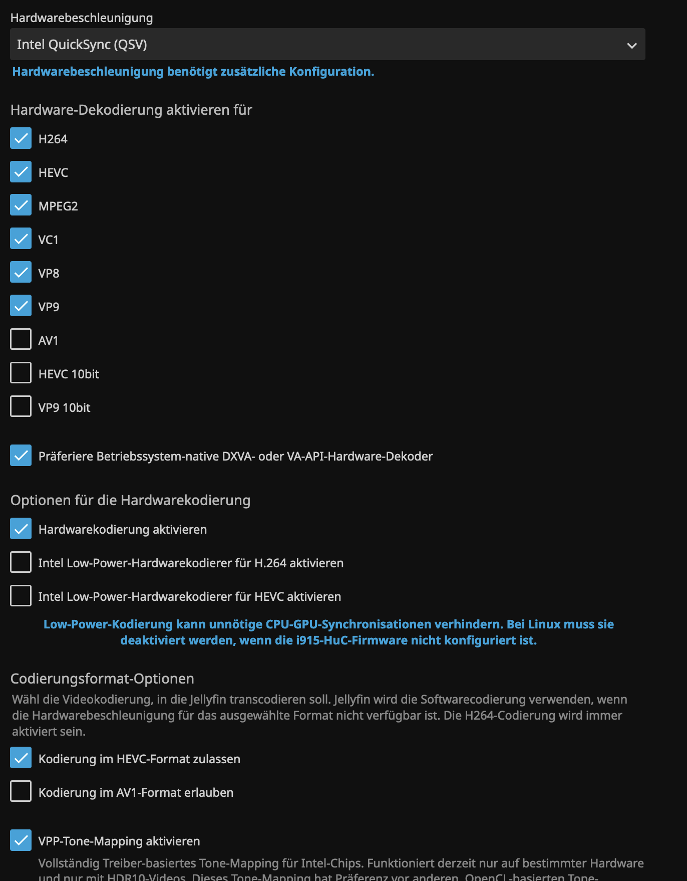

    My transcoding settings are like…
    Isn't it strange that it works in Jellyfin Web but not on android?

    Thank you, but changing this doesn't help.
    If I switch decoding from QSV to VAAPI the video will play on android, but with stutters and cpu usage goes up quite a lot. On Jellyfin web it still plays smoothly without stressing the cpu.
    The other video causes almost no cpu usage on both platforms – It stays the same for QSV and VAAPI decoding.
