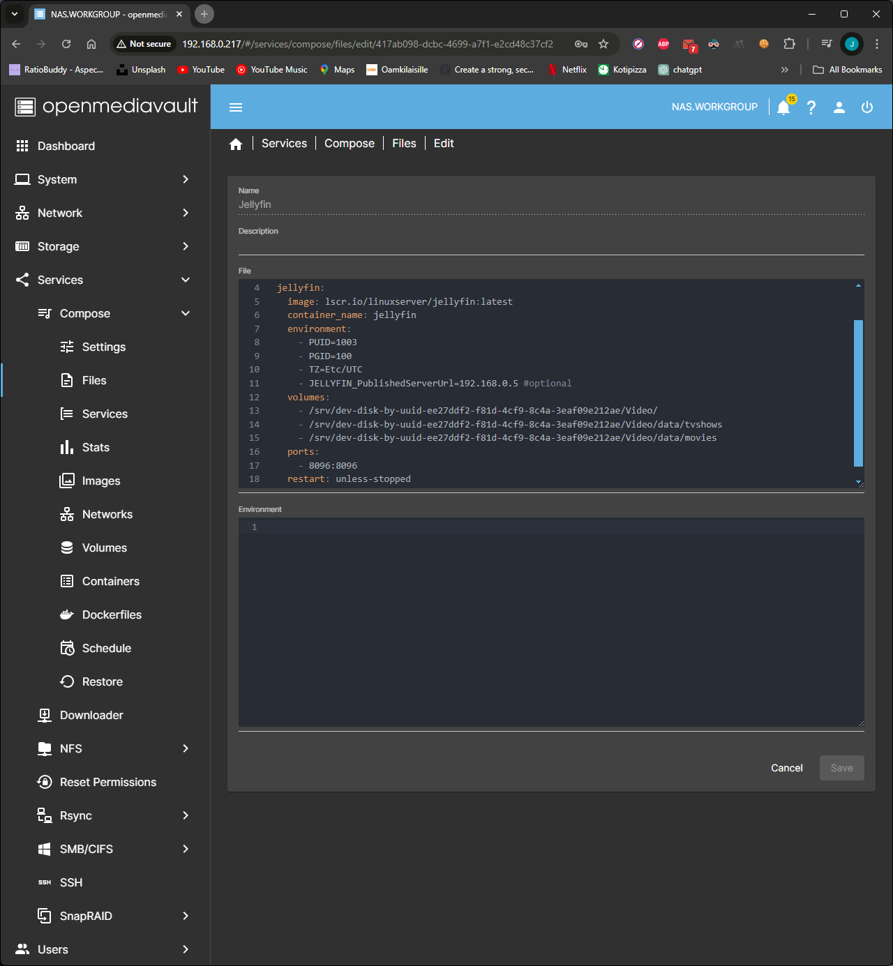

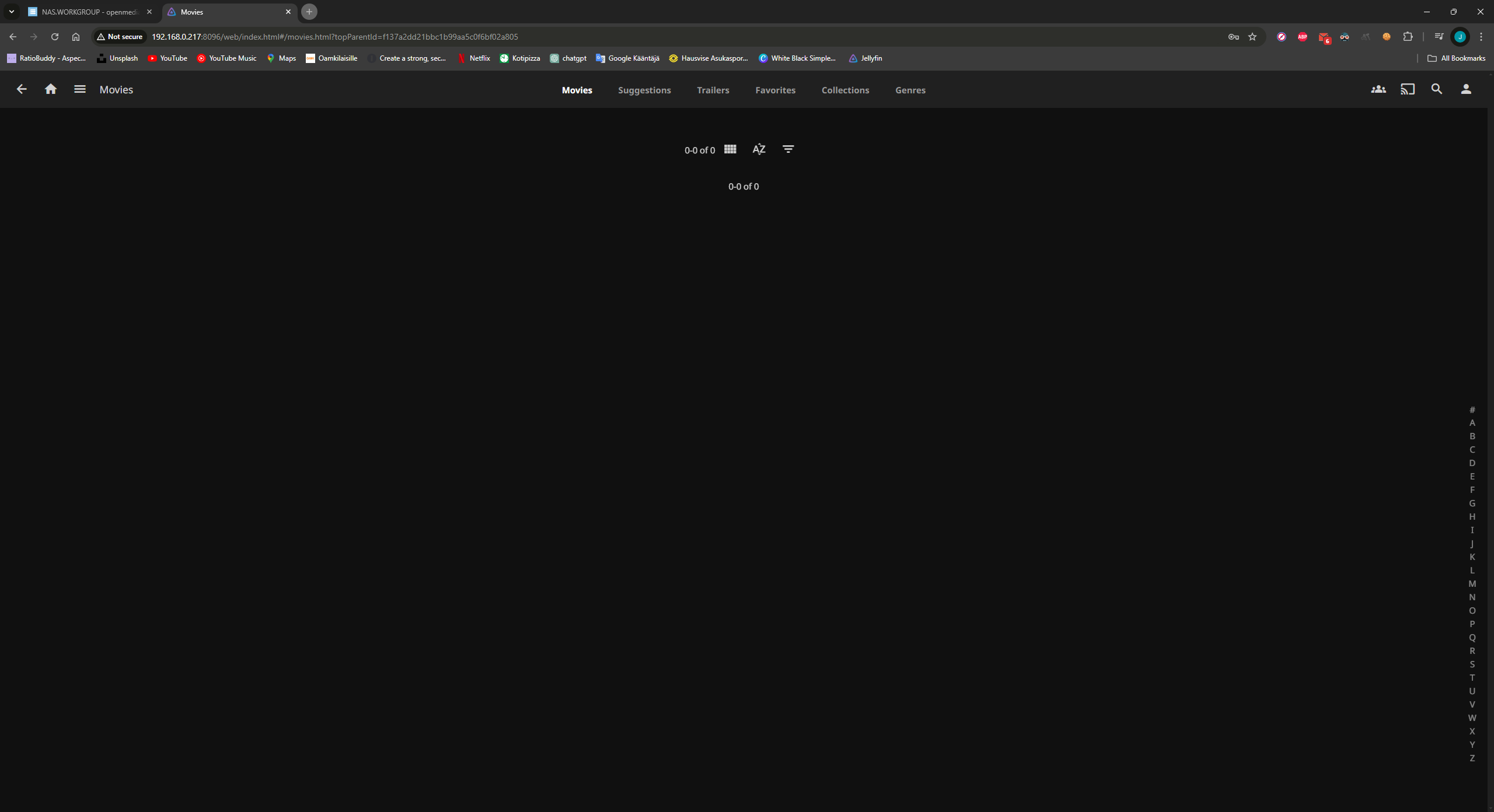

    So I have jellyfin installed on omv6 nas. The omv6 compose corrupted and I had to reinstall it.
    Once reinstalled and getting jellyfin up again. None of my videos, shows, movies, etc show up.
    I think I set everything up the same way it was before and it worked fine.
    https://pastebin.com/KpR2DbAM
    2024-09-07, 08:51 PM
    You forgot to put a colon in between the host and container paths.
    Taotaka
    2024-09-08, 11:46 AM
    added the colon and now it's telling me mount path must be absolute
    https://pastebin.com/43zszJ18
    current file
    https://pastebin.com/mveVZum4
    2024-09-08, 03:55 PM
    You missed the leading slash after the colon on this line.
    - /srv/dev-disk-by-uuid-ee27ddf2-f81d-4cf9-8c4a-3eaf09e212ae/Video/data/movies:data/movies
    Should be
    - /srv/dev-disk-by-uuid-ee27ddf2-f81d-4cf9-8c4a-3eaf09e212ae/Video/data/movies:/data/movies
