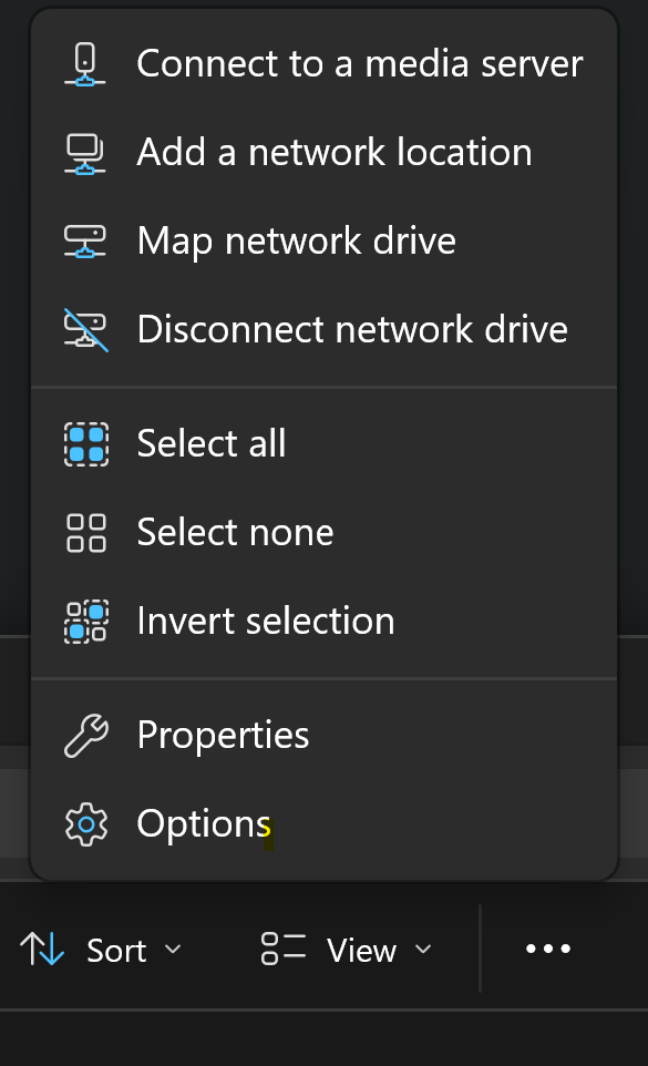

    (2024-11-26, 02:23 PM)wtftad Wrote: Basic smb connections with the drive shares created in windows explorer “add network location”.
    You need to use the "Map network drive" option, not "Add network location."
