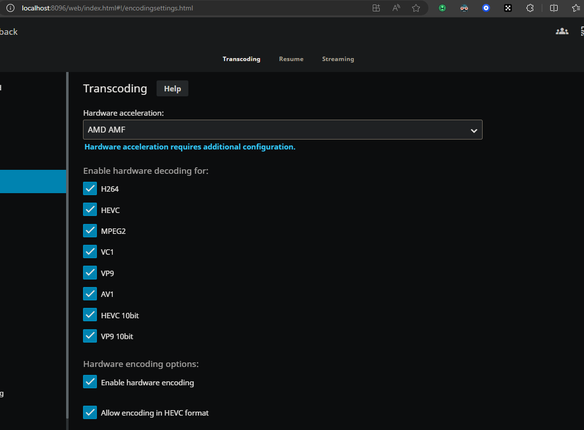

    Can you show me screenshots of Dashboard > Playback? What codecs are checked?

    2024-01-16, 09:08 AM
    attaching screenshot

    (2024-01-16, 09:08 AM)chicri Wrote: attaching screenshot
    This isn't a solution for your current issue really but the RX 7800 XT does not have support for decoding all those codecs
    It can do H264, HEVC + 10bit, VP9 + 10bit, and AV1
    MPEG-2 and VC-1 are not supported in AMD VCN 4.0
