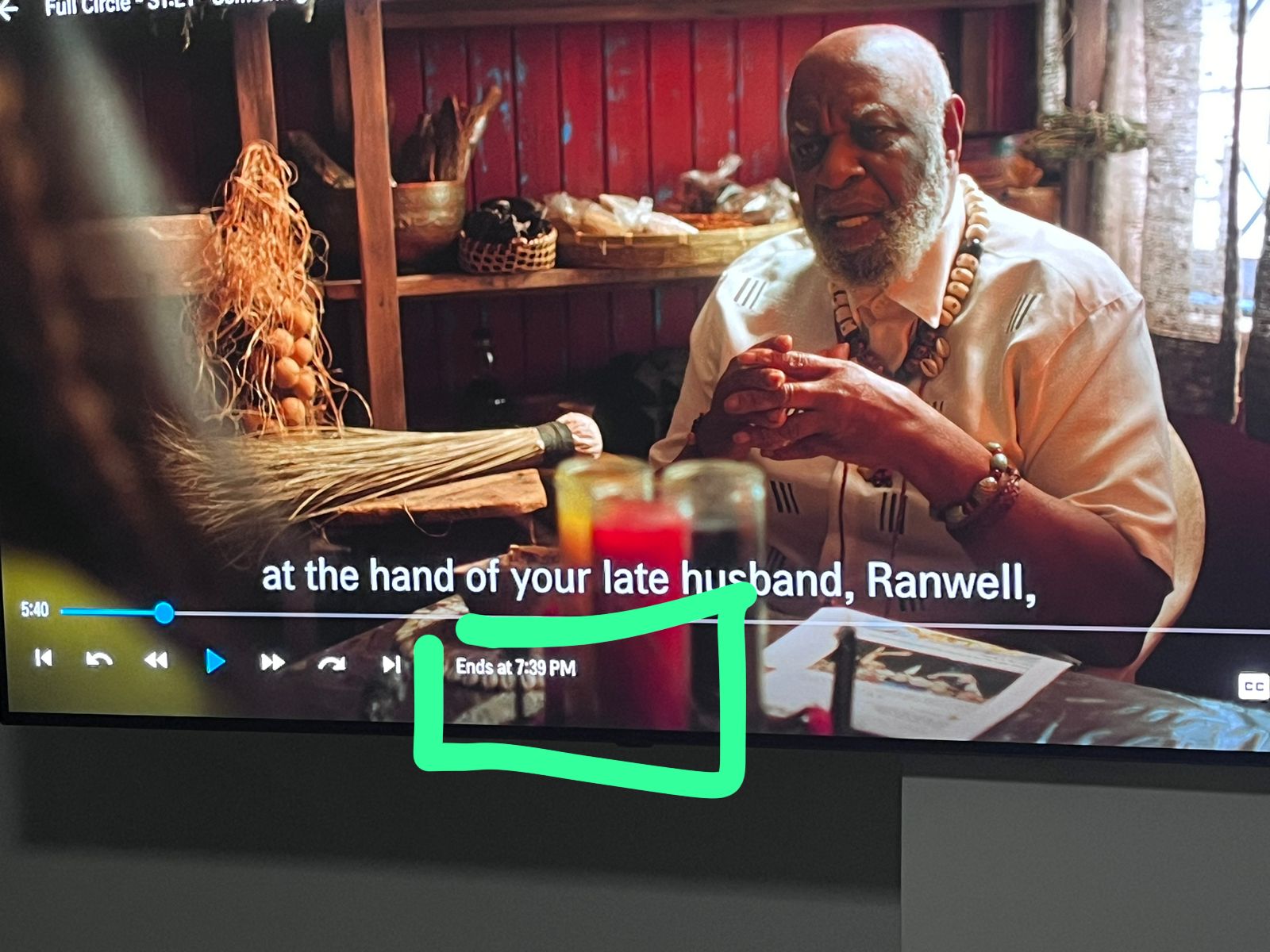

    Hi community; I am facing something odd, when I play something in the lower section of the navigation menu in fellyfin shows the hour and minute that the movie/show will end
    This only happens in my LG C1 i have a new G3 and it shows the proper end time
    I was wondering if someone has being able to fix this

    on jellyfin was end time shows 7:39PM
    the time of the capture was 1:46pm
    the episode es 50 minutes so the end time should be more like 2:30PM so it is off like 5 hours
    mi timezone is GMT -5
    so am thinking that is using GMT but is not taking the -5
