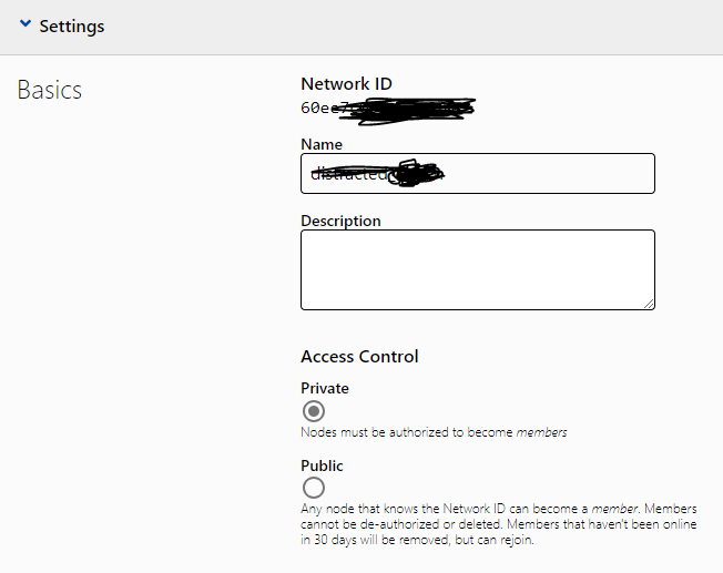

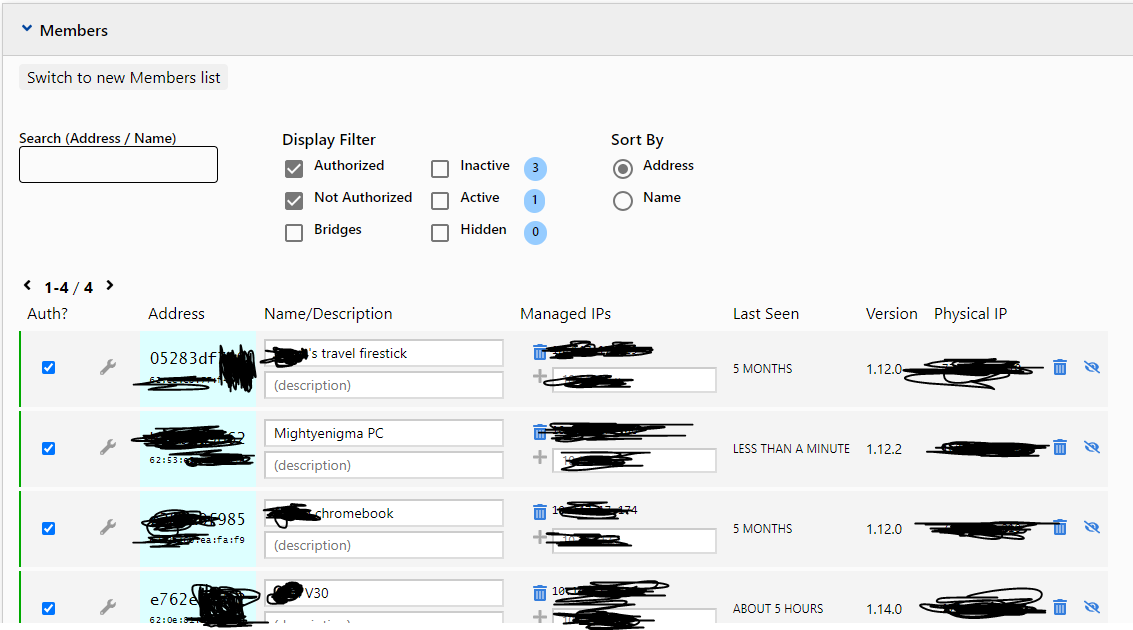

    This is the ZeroTier interface after I log in to https://my.zerotier.com/network , first page:
    Here is the page that goes to when I click on the Network I have been using for the other apps to reach my home server. This is the Members section. As you can see, it is about the device but not the specific apps:
    Other sections are Settings:
    And Flow Rules which looks like this:

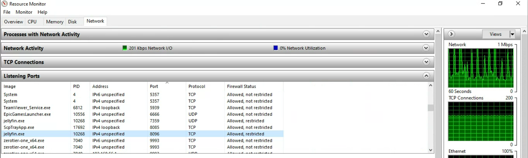

    Click start > type Resource Monitor > click on the Network tab > expand the Listening ports table
    Find jellyfin.exe on port 8096. What is the firewall status and what does it say about the address it is bound to?
    mightyenigma
    Posts: 16
    2024-06-21, 09:15 PM
    (2024-06-21, 08:17 PM)TheDreadPirate Wrote: Click start > type Resource Monitor > click on the Network tab > expand the Listening ports table
    It says IPv4 unspecified
    Firewall is Allowed, restricted.
    (attached screenshot)
    2024-06-21, 09:36 PM
    Should be unrestricted. Make sure that jellyfin.exe is allowed in Windows Firewall or open port 8096 specifically.
