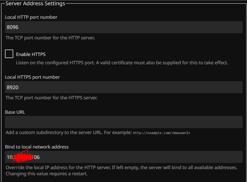

    Try configuring Jellyfin to specifically bind to both your LAN IP and Zerotier IP.
    Also, you stated that Jellyfin is now allowed on private networks, but are both the LAN NIC and Zerotier "NIC" set as private networks?

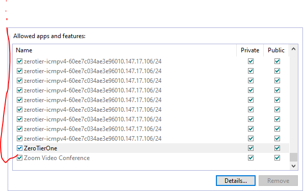

    #16
    2024-06-22, 09:13 PM
    (2024-06-21, 11:31 PM)TheDreadPirate Wrote: Try configuring Jellyfin to specifically bind to both your LAN IP and Zerotier IP.

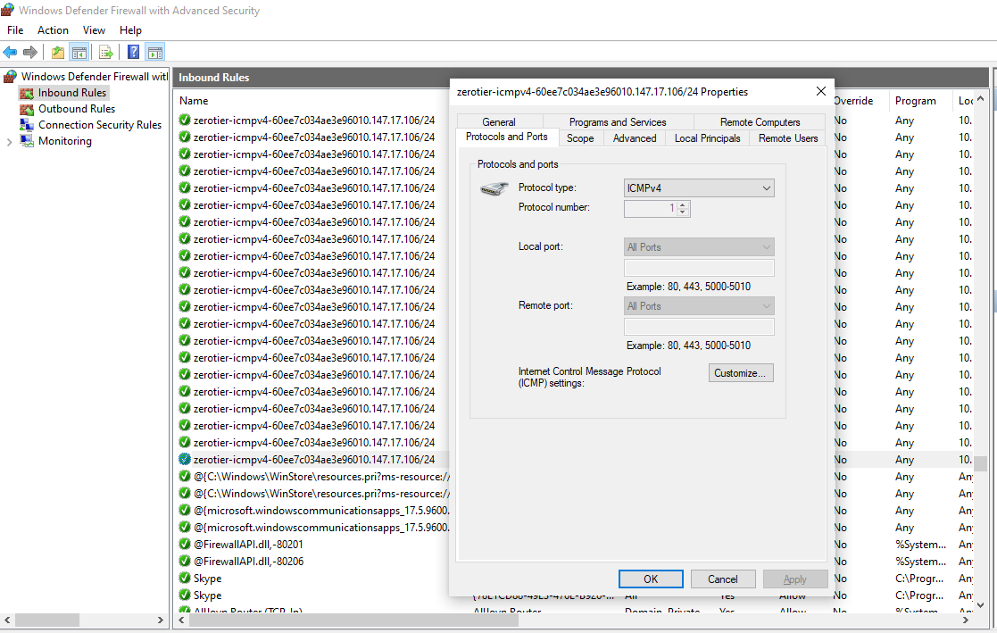

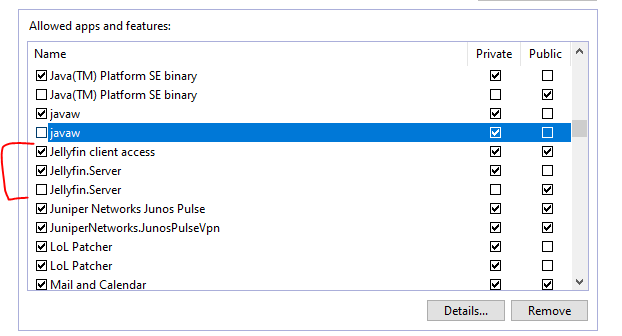

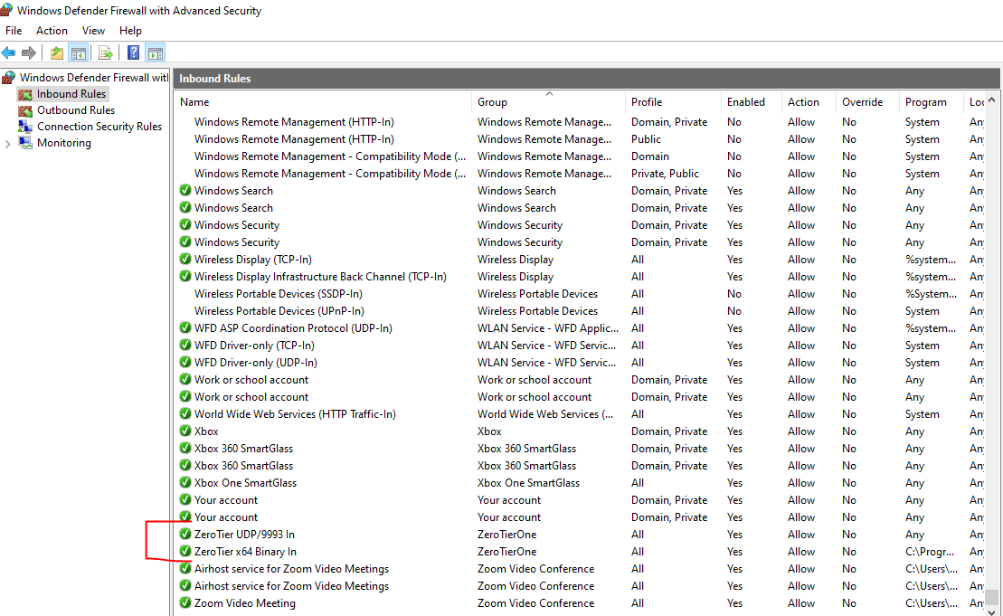

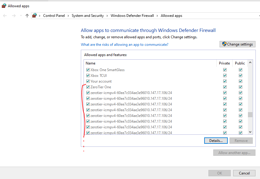

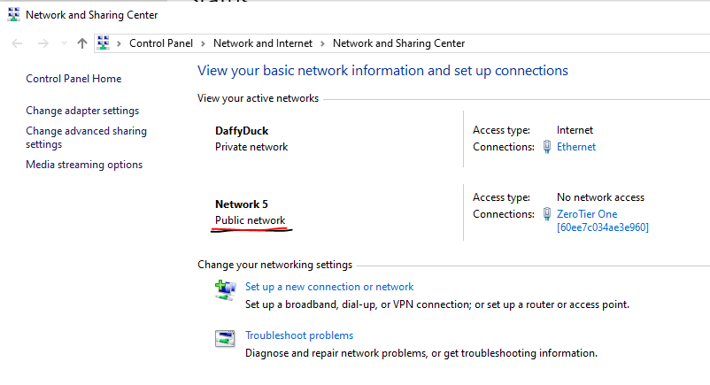

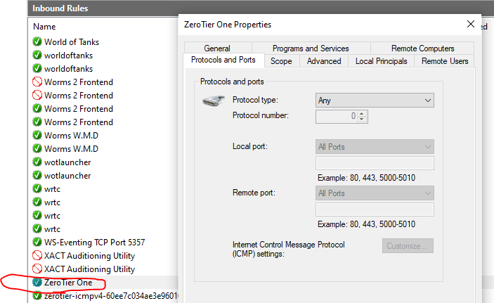

    I attached a lot of screenshots of various things in my firewall related to ZeroTier and Jellyfin.
    One of the screenshots shows that ZeroTier is indeed showing up as a Public network, not private.
    I saw that Jellyfin is set to Private networks only, so I changed it to also work on Public networks. Not sure if that's necessary since there is another app called Jellyfin client that is already on public, but maybe that is for when the host machine is accessing another host or itself as a client.
    However, despite this change, and also specifically opening port 8096 both Incoming and Outgoing for TCP, I get the same error when trying to log in from my phone over Zerotier.
    Strangely, the port 8096 rule I added yesterday has disappeared so I had to put it in again. I named it differently "ZT 8096 TCP In" and "ZT 8096 TCP Out" in case ZeroTier is wiping it out due to it having the same name.
    Not sure where to go from here. Does it matter that in the screen that showed ZT being public, it also said "No network access"?

    2024-06-23, 02:35 AM
    (2024-06-23, 01:05 AM)TheDreadPirate Wrote: I saw mentioned somewhere (I don't recall where) that Jellyfin actually only listens on one NIC.  I think the solution is to tell Zerotier to bridge the Zerotier interface to the LAN interface.
    https://www.reddit.com/r/zerotier/commen...indows_10/
    Interesting article. It sounds like a different use case than mine, but I hadn't thought of installing ZeroTier directly on the router itself.
    Maybe this is too complicated.
    I tried binding to the ZeroTier IP address instead, and had to type that in to log into my server on the host machine, but doing this did not make it notice or acknowledge incoming login from my JF phone client.
