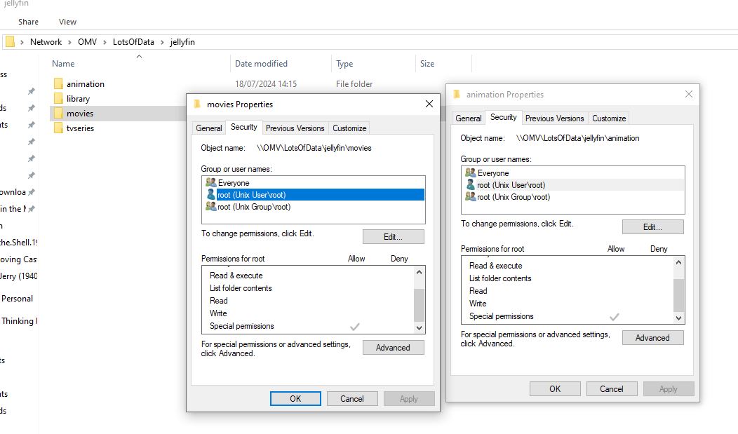

RE: JF folder locations - noob - 2024-07-18
Permissions - looks the same as the other, as you said,I created the folder in the same location as the default ones.

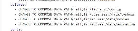

Found where to add it to the docker service and rebooted it.
Indicated to add " /data/animation" when creating new library in JF dashboard
Still does not find it Confused-face
RE: JF folder locations - TheDreadPirate - 2024-07-18
You have the same source folder mapped to two different container mount points. That's not going to work.
If you have animation movies in the movies folder, you would have to move them to a different source folder.
