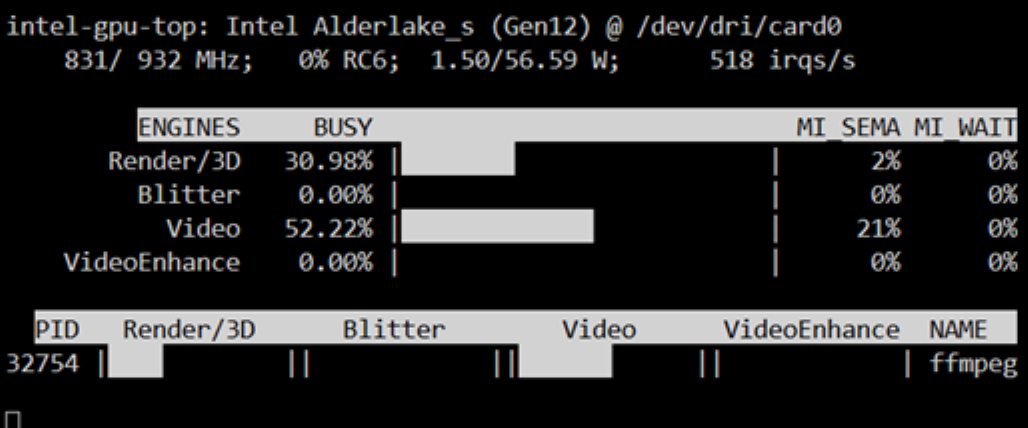

Am I using the hardware acceleration correctly? - Grimlock - 2024-03-13 Pretty new to everything Jellyfin CPU is a 100% while transcoding, but it appears the iGPU isn’t working very hard: Or is it just a matter of working/not working and this is just expected performance? Jellyfin is deployed as a docker from the linuxserver repository on my unraid system. Intel Quicksync (QSV) has been enabled. Intel GPU TOP plugin is installed and the --device=/dev/dri:/dev/dri flag has been added System CPU: 12th Gen Intel® Core™ i3-12100 @ 3267 MHz Memory: 32 GiB DDR4 RE: Am I using the hardware acceleration correctly? - TheDreadPirate - 2024-03-13 Is a single core running at 100%? Or all cores? A single core at 100% probably means that the audio is transcoding on the CPU, which is expected. Can you share your ffmpeg log with us via https://sourceb.in/ ? RE: Am I using the hardware acceleration correctly? - Grimlock - 2024-03-13 All cores are pretty much at 100% Here are my FFmpeg logs https://srcb.in/eyLyRzzGy2 RE: Am I using the hardware acceleration correctly? - TheDreadPirate - 2024-03-13 It is using the iGPU. Code: Stream #0:0 -> #0:0 (hevc (native) -> h264 (h264_qsv)) Your video is a bit weird. It has 2 video streams? One with and without Dolby Vision? Did you apply the Intel OpenCL mod for the LSIO Jellyfin container? Can you share the full docker config for Jellyfin? RE: Am I using the hardware acceleration correctly? - Grimlock - 2024-03-13 Here is where my inexperience starts to show... ![]() How do I share my docker config from unRaid? this is what I could grab: https://sourceb.in/267c2UwI8Z I did not apply the Intel OpenCL mod for the LSIO Jellyfin container... but I would not know how here is a link to another file transcoding log if that's helpful: https://sourceb.in/GFU2e5wJNF RE: Am I using the hardware acceleration correctly? - TheDreadPirate - 2024-03-13 You have to add an environment variable to the Docker config for Jellyfin. https://github.com/linuxserver/docker-mods/tree/jellyfin-opencl-intel Code: DOCKER_MODS=linuxserver/mods:jellyfin-opencl-intel Since your video is HDR, you need the OpenCL mod. RE: Am I using the hardware acceleration correctly? - Grimlock - 2024-03-13 Thanks for the help. I've added the mod, but still CPU is running at 98~100%. RE: Am I using the hardware acceleration correctly? - TheDreadPirate - 2024-03-13 For a sanity check, can you try another video? Preferably one that isn't HDR? The video we've been trying is a bit weird. Has two video streams. Code: Stream #0:0[0x1](und): Video: hevc (Main 10) (hev1 / 0x31766568), yuv420p10le(tv, bt2020nc/bt2020/smpte2084), 3840x2160 [SAR 1:1 DAR 16:9], 60746 kb/s, 23.98 fps, 23.98 tbr, 24k tbn (default) The first 4K HEVC 10 stream and a separate HEVC 10 + DOVI 7.6 stream that is 1080P instead of 4K? Its a bit unusual. Normally you have the HEVC and DV side channel in the same stream. RE: Am I using the hardware acceleration correctly? - Grimlock - 2024-03-15 Sorry - Took me a while to test out another video This one is better but still chewing up 85% ~ 90% CPU Here are the logs: https://sourceb.in/ZkVVVQDvJz iGPU looks a little better though? RE: Am I using the hardware acceleration correctly? - TheDreadPirate - 2024-03-15 For testing, can you spin up a jellyfin/jellyfin docker image? I've found that the LSIO docker image behaves differently than the official image in a lot of weird ways. This may be another. Replace the group_add value with the GID of the render group on your PC. Add your media paths, etc. Code: version: '3.5' |
