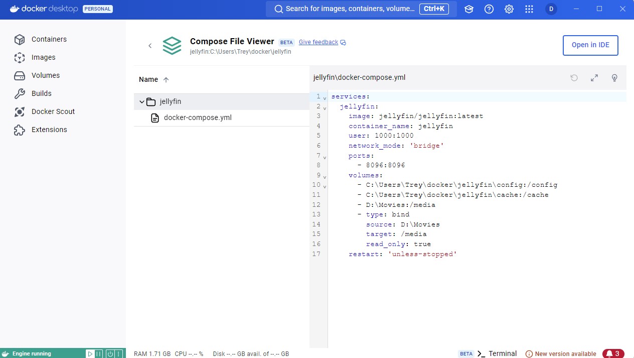

Sorry if this is posted. I have spent days reading posts and either don't understand it correctly or haven't found what I need. I am running Windows 11 with Jellyfin on Docker. It doesn't matter if I host on my gtx1050 or my other computer with rtx3090TI, as soon as I turn on transcoding I get fatal Error when trying to play any movie. I have movies saved as MP4 but tried also MKV. If I run without transcoding it is extremely laggy to the point of not being watchable on TVs or phone. I have attached my yml file. Also, probably the most important information is I am new to all of this, docker, jellyfin, all of it. So I won't understand much unless you dumb it down for me. Any Help would be greatly appreciated. I have read all the walk throughs and don't understand 80 percent of it. I attached my log just in case there is somthing there that I am to slow to understand.

RE: Windows, Docker, RTX3090ti - TheDreadPirate - 2024-09-26
You didn't pass the GPU into the container. Read our docker documentation here.

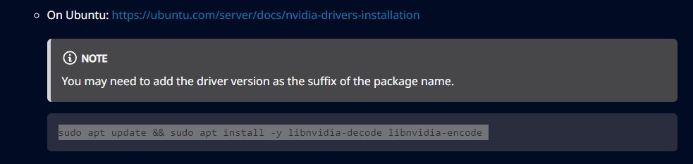

I have spent hours now attempting this. rookie eyes don't understand. I have now installed ubuntu, Nvidia driver 552.12 is installed but I am hung up on:  sudo apt update && sudo apt install -y libnvidia-decode libnvidia-encode and how to get this command to work. I have tried adding 552.12 to the end in all different ways but I really don't know how to properly type it. I am however understanding docker and ubuntu a little more after all of this lol. So much of this information isn't working and I am having to try multiple sources for work arounds. (I am sure it is due to me not fully understanding what I am doing.)
RE: Windows, Docker, RTX3090ti - TheDreadPirate - 2024-09-27
What is it doing or not doing when you run that apt command?
