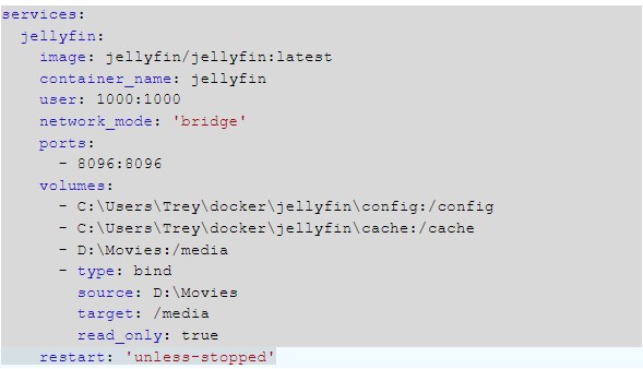

    Sorry if this is posted. I have spent days reading posts and either don't understand it correctly or haven't found what I need. I am running Windows 11 with Jellyfin on Docker. It doesn't matter if I host on my gtx1050 or my other computer with rtx3090TI, as soon as I turn on transcoding I get fatal Error when trying to play any movie. I have movies saved as MP4 but tried also MKV. If I run without transcoding it is extremely laggy to the point of not being watchable on TVs or phone. I have attached my yml file. Also, probably the most important information is I am new to all of this, docker, jellyfin, all of it. So I won't understand much unless you dumb it down for me. Any Help would be greatly appreciated. I have read all the walk throughs and don't understand 80 percent of it. I attached my log just in case there is somthing there that I am to slow to understand.

    Can you share your docker config? And the ffmpeg jellyfin generates? Its in the same directory as the one you attached.

    2024-09-26, 08:15 PM
    You didn't pass the GPU into the container. Read our docker documentation here.

    2024-09-26, 11:57 PM
    If you are running on windows we do not recommend using docker because you are end up with VM + docker and that makes it very hard or even impossible to have working hardware acceleration. We do provide windows native server packages and you should use that instead which will make your life much easier if you want to use your GPU.
