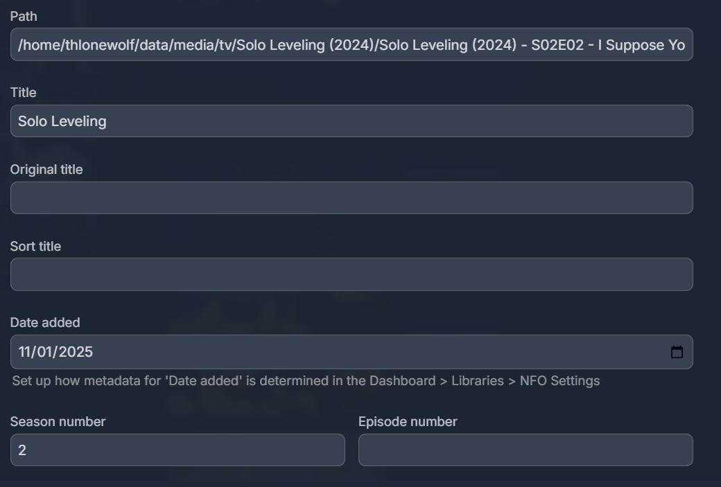

    Hi
    I have added the solo leveling anime in Jellyfin.
    The metadata of the first season works fine, but the metadata of the second season is incorrect.
    This is an example of the location of an episode.
    /home/thlonewolf/data/media/tv/Solo Leveling (2024)/Solo Leveling (2024) - S02E02 - I Suppose You Arent Aware [WEBDL-1080p][EAC3 2.0][h264]-ToonsHub.mkv
    However the metadata does not seem to be filled in correctly (see attached file).
    Might someone have an idea at what might be wrong?

    2025-02-23, 08:37 PM
    Make sure to use TheMovieDB as your main provider and either lower the priority, or disable the other anime plugins.
    AniDB and AniList don't follow seasons and instead treat seasons as a new show.
    TMDB will follow seasons for a show.

    Thanks for the reply
    After adding TheMovieDb as the main metadata provider, it now sees the seasons and episodes correctly, but the episode name is the one of the first season?
    Also what exactly do you mean by 'TMDB will follow seasons for a show'? Is this not what is supposed to happen?

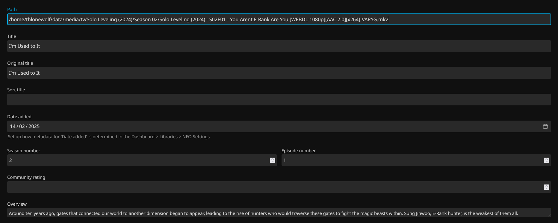

    After re-scanning the entire show library and replacing the metadata, it still shows the thumbnail and title of the first season. So S02E01 shows the title and thumbnail of S01E01.

    Thanks for your reply. I tried the following structure:

    However, this still doesn't add the correct metadata even after refreshing it all.
