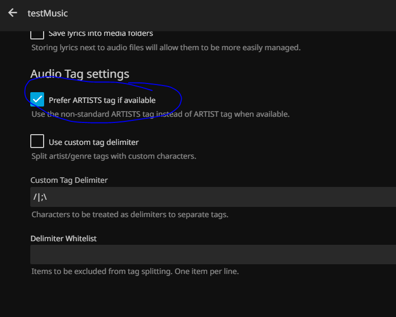

    2025-03-10, 03:07 PM (This post was last modified: 2025-03-10, 03:08 PM by TheDreadPirate. Edited 1 time in total.)
    I can't remember if this setting is available in 10.9.  Go into the library settings for your music library and check whether this setting is enabled or not (see screenshot below).
    "ARTIST" is the standard tag. "ARTISTS" is a non-standard tag, but fairly common in music files. Jellyfin will use "ARTIST" by default unless you enable the setting in the screenshot above to tell Jellyfin to use the "ARTISTS" tag.

    (2025-03-10, 03:07 PM)TheDreadPirate Wrote: I can't remember if this setting is available in 10.9.  Go into the library settings for your music library and check whether this setting is enabled or not (see screenshot below).
    Wow!  This worked, but it doesn't work until I do a "Refresh Metadata" on each album.   I tried a full inventory scan and that doesn't do it.  Is there anyway to force this for albums already in the library?
    Thank you so much!
