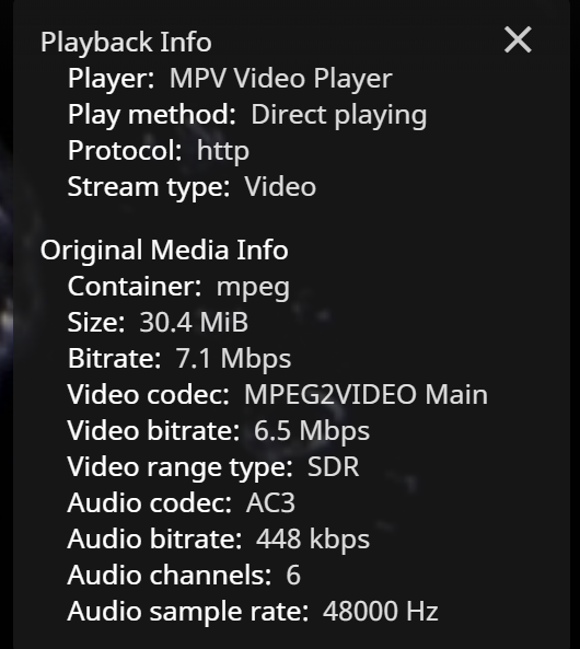

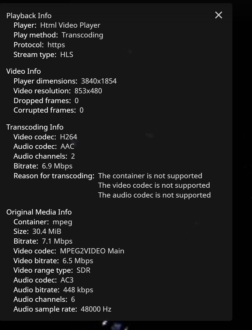

    Oooh. Finally get to test an obscure-ish piece of media.
    Mediainfo says this contains EX:
    ID                                      : 189 (0xBD)-128 (0x80)
    Format                                  : AC-3
    Format/Info                              : Audio Coding 3
    Commercial name                          : Dolby Digital
    Format settings                          : Dolby Surround EX
    Muxing mode                              : DVD-Video
    Channel(s)                              : 6 channels
    Channel layout                          : L R C LFE Ls Rs
    Granted it's in the original VOB container right off a DVD. Tested in Firefox, gets identified as AC3 transcoded to AAC without a hitch. Tried in Jellyfin Media Player, and it's direct playing it as AC3 using MPV. I don't have the equipment to test if I'm actually getting the EX channels out of it or if it's just playing the core AC3 stream, but it's still playing.
