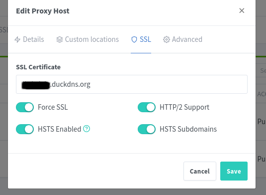

    Can you share screenshots of Nginx Proxy Manager? All the tabs for the Jellyfin proxy. Censor your domain name.

    2025-04-21, 08:05 PM
    See attached.

    2025-04-22, 05:47 AM (This post was last modified: 2025-04-22, 05:54 AM by Duvel. Edited 3 times in total.)
    in NPM on the Proxy Hosts tab, your destinations are https:192.168.x.x:3013 and https:192.168.x.x:80
    This is wrong.
    The goal of your reverse proxy is to handle the htpps encryption and decryption using the certs. Its all the traffic from and to the internet on your npm that is encrypted and using https, everything between NPM and your LAN is not.
    The reverse proxy destinations on your LAN should therefore use http and not https.
    The jellyfin config looks fine as you didnt activate the "enable https". So Jellyfin is only listening on http port 8096.
    But then you should have on your NPM destination for jellyfin soemthing like
    http://192.168.x.x:8096

    Ok, so that kind of worked, but not with 8096, 30013 with HTTP did. However when trying to connect to the domain outside the LAN (on my phone with the wifi off, for example) the page does not load. So that means I still can't access it from outside the house. I had a friend try the domain, the page did not load.
    is the DuckDNS current IP supposed to be set to the LAN address?
    See attached.
