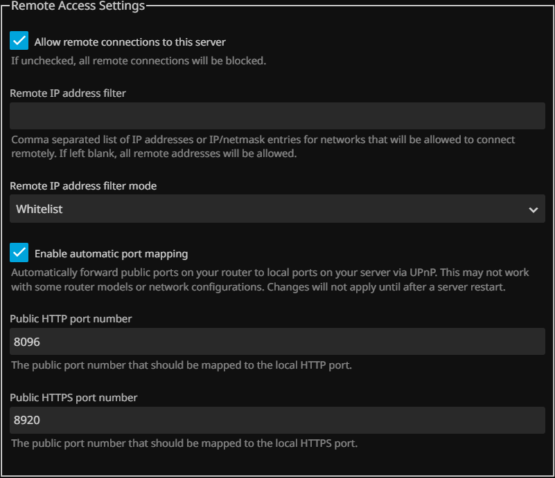

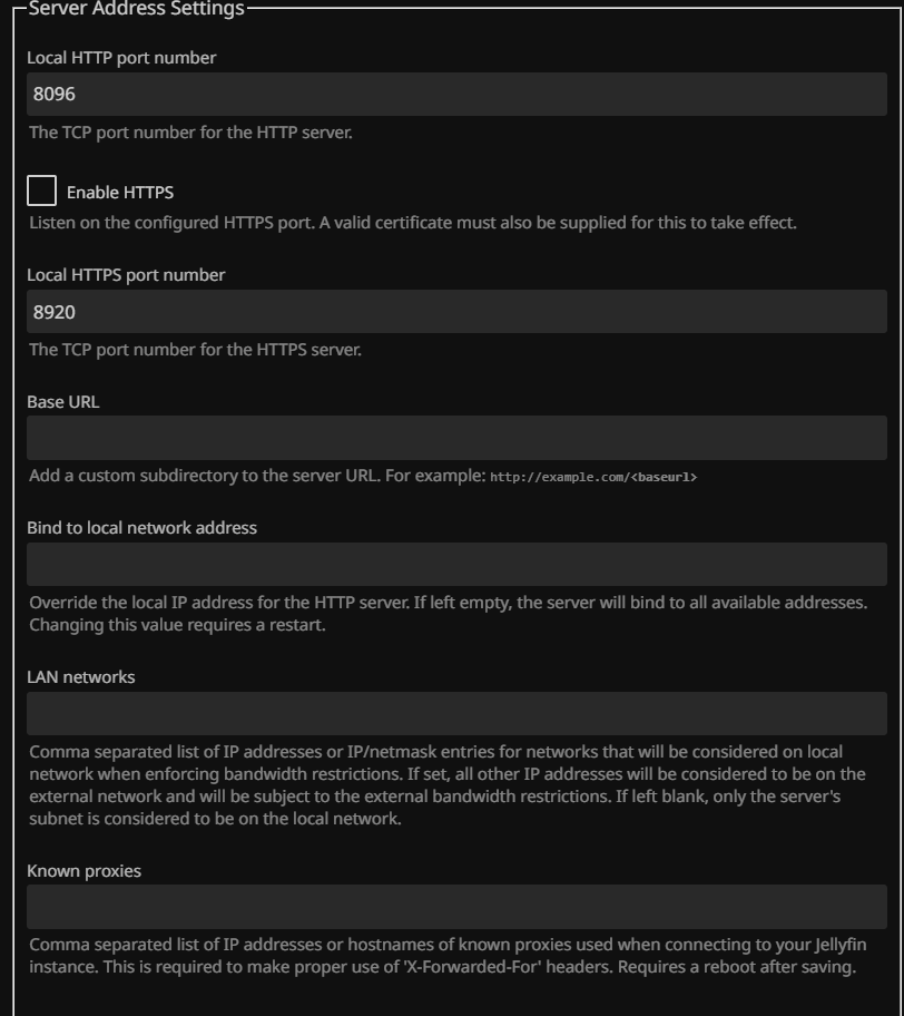

    In regards to the ports, it does look like Jellyfin is automatically mapping them. Though I do have 8096 as the local HTTP port number, though does that serve a different function than the Automatic Port Mapping check box? I've attached screenshots of my Jellyfin port settings so you can take a peek. Do I need to fill in any of the "Bind to Local Network address, Lan Networks, or Known Proxies" boxes?

    Since you are using Caddy, you do NOT need automatic port mapping enabled. That setting will open ports 8096 on your router, which you are not using for remote access. At least I don't think so. When you connect from a remote client, are you using https://domain.duckdns.org? Or http://domain.duckdns.org:8096?

    Double check that port 80 and 443 are setup correctly in your router. If they are, it is possible that your ISP is blocking those ports.
    Assuming your ISP is NOT blocking port 80 and 443, ideally you would remove port 8096 from your router's port forwarding. This forces all external connections to go through caddy. Going directly to port 8096 bypasses caddy.
    You COULD use a different port entirely and route that to caddy. Most routers allow you to define an external port and redirect it to a different internal port.
