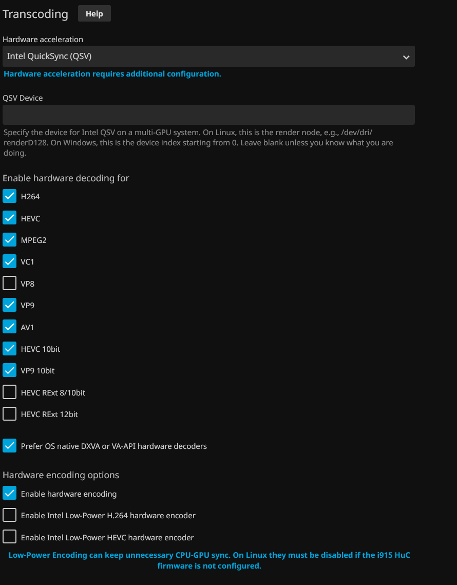

    Hi all!
    I have tried unsuccessfully for quite some time to get hardware transcoding to work properly... So I am reaching out hoping for some help.
    The short of it is, with hardware transcoding disabled videos work, and my TV channels appear to intermittently work (Jellyfin seems to hang once it attempts a stream and it doesnt work).
    However when enabling hardware transcoding I cannot get anything to play.
    I am hosting Jellyfin in a docker container with docker compose (attached) on Ubuntu 24.04.2 LTS with an Intel Core i5-13600K attempting to use QSV..
    Attached are screenshots of my transcoding settings, and the ffmpeg output from an attempted video with hardware transcoding enabled.
    Thanks in advance!
    ffmpeg - https://pastebin.com/ZB2Ht0zK
    dockercompose - https://pastebin.com/Jdt0xLgg
    PS - the docker setup is routed through another container's network hence why the port forwarding isnt in this docker compose.
    Any help would be greatly appreciated

    2025-04-19, 07:34 PM
    From a transcoding perspective, the ffmpeg log looks fine. Nothing unusual or special.
    What kind of client are you watching on? Does this happen on all clients or just a particular client?

    2025-04-19, 10:34 PM
    Thank you for the reply sir! So interestingly if I attempt to play from chrome on windows instead of Firefox (what i was testing with) it plays about 9 seconds properly, then freezes and immediately downgrades the quality and stutters until I stop playback...

    2025-04-20, 01:19 AM
    Can you share the main jellyfin log?

    2025-04-20, 09:50 PM
    Hey man I will, thank you again for the help. Currently I have hardware transcoding disabled, and everything works perfectly across the board (with the exception of live tv on my nvidia shield device and apple tv both using jellyfin and swiftfin respectively).
    I will re-enable it though and provide the logs.
    Also I had another question.. Do you happen to know is there a way to use an epg guide using the jellyfin.xtream addon to provide channels? Instead of a tuning device?

    2025-04-20, 10:27 PM
    I also forgot to mention a few other things - I am accessing it through a nginx proxy using nginxproxymanager (i do have the no proxy buffering setting set)
    - Also it seems to stream much better with max 1080p set, previously I noticed it was streaming about 500mbs to the browser every other second, with 1080 set as the resolution it appears to be getting around 600 fps lol and a bitrate of 670 (without hardware transcoding enabled)

    2025-04-20, 11:20 PM (This post was last modified: 2025-04-20, 11:21 PM by TheDreadPirate. Edited 1 time in total.)
    I have zero experience with EPG guide data.
    Do you have "Cache assets" enabled in Nginx Proxy manager? Are you using cloudflare as a proxy?

    2025-04-21, 02:37 AM
    Hey! No worries about the EPG guide data, here is my regular jellyfin log: https://pastebin.com/DHqvHLV8
    And I do not have cache assets enabled in nginx proxy manager, and I am not using cloudflare as a proxy just through nginx on my local network

    2025-04-21, 03:44 AM
    Just to give you an update as well, I think my Ubuntu environment might be in poor shape, I'm going to wipe it tomorrow and start with a clean install

    2025-04-21, 07:28 PM
    So I uninstalled Ubuntu and installed Debian instead, and have everything up and running again but am running in to the same issue Smiling-face
    Main jellyfin log: https://pastebin.com/EyDuvFkM
    ffmpeg log: https://pastebin.com/x4EFmG7H
    When I attempt to view it in Firefox in the jellyfin web UI:
    It appears to attempt to request the same 447.01 mb file over and over again, when i open it on firefox directly it says: 'no video with supported format and MIME type found'
    If I open it in Chrome it appears to send video at nearly 1gbps/second to the client
    It streams 9 seconds and then pauses
    this is the media info I get for those 9 seconds
    Playback Info
    Player
    Html Video Player
    Play method
    Transcoding
    Protocol
    http
    Stream type
    HLS
    Video Info
    Player dimensions
    1509x557
    Video resolution
    1920x800
    Dropped frames
    0
    Corrupted frames
    0
    Transcoding Info
    Video codec
    H264
    Audio codec
    AAC
    Audio channels
    2
    Bitrate
    293.6 Mbps
    Transcoding framerate
    46 fps
    Reason for transcoding
    The container is not supported
    The video codec is not supported
    The audio codec is not supported
    Original Media Info
    Container
    mkv
    Video range type
    SDR
    If I wait it will continue at a lower streaming quality, and then pause again (downloading about 5gbs in 20ish seconds)
