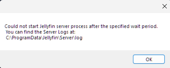

    I am using Jellyfin 10.9.6
    Whenever I try to start Jellyfin, I get a windows error pop-up, see attached image.
    The error is: "Could not start Jellyfin server process after the specified wait period." and then where to find the logs.
    I have been going crazy for the last few days trying to track down what's wrong here, and can't find any information online, or common issues. The wording is also really confusing. Why does Jellyfin have a specified wait period, and how do I disable that? Assuming it's not stopping another error? And why won't it let me start Jellyfin at all?
    A few days ago I could start Jellyfin after getting that error by restarting my server computer, but not it happens regardless. Jellyfin can open in my windows system tray, but whenever I try to start my server, it doesn't run, and after a few seconds I get the error. I also can't find anything off in my logs: https://pastebin.com/vQkvdnYc
    In which only one was created.
    Can anyone help me with this?
    Edit: Apparently it works if I run it as administrator, which it doesn't do automatically anymore, and I can get onto the website, but I can't log into any profiles. It's an infinite load, and I can't use it.
