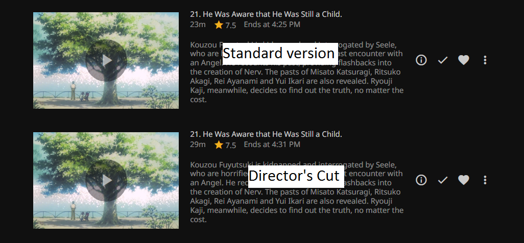

    You can keep them separate or use some of Jellyfin's functionality to have both versions together. Jellyfin currently supports multiple "versions" of a movie in a graceful way (see first screenshot below).  And that can mean resolution/quality or some other differentiator.  Shows kind of supports "versions" but not as gracefully (see second screenshot).
    For movies, selecting the "version" and then download should download that version.
    You could setup a separate library, but that also means having multiple results when you search for something.  And separate watch statuses for each library.
