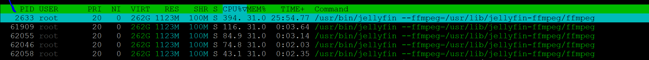

    Please review my logs and CPU usage data.

    Well that is not really what we need, do you have a transcode log or a log from within jellyfin as well?
    Also even if you disable video transcoding this would allow for audio transcoding or burning in subtitles which are CPU tasks.
    Thinking about it even just repackaging the container to HLS will be a heavy task for a raspi4
    Also Docker within raspi is another performance penalty....
    2024-10-17, 03:25 PM
    There are multiple ffmpeg processes, which tells me this is either a library scan or trickplays generating.
    If you see this again, run this command and share the output.
    sudo ps -aux | egrep "jellyfin|ffmpeg" | cat
    If these are ffmpeg processes related to either a library scan or trickplays, there are settings to cap the number of threads.
    Dashboard > General > Parallel library scan tasks limit/Parallel image encoding limit
    Dashboard > Playback > Trickplay > FFmpeg Threads

    You'd have to share your full log the next time it happens. The log should container the full ffmpeg command, which would indicate what is spawning the process.
