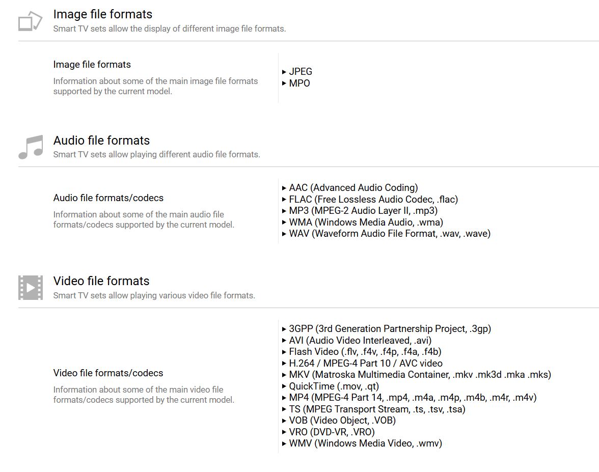

    I have an older (10+ years) Panasonic TV "tx-55as750w" with no Jellyfin App available. I installed the DLNA Plugin on my server and it is working fine with MP4. Mp4 is supported by the TV. Now I need a working DLNA Profile for transcoding mkv H.265 Files to for example mp4. I searched the internet for a solution but still it will not work. I managed to create a new Profile for the TV and copied the standard "Panasonic Viera" from "C:\ProgramData\Jellyfin\Server\plugins\DLNA_4.0.0.0\profiles". At the start the server log showed that the default profile was used because the tv was not recognized. now the log is fine. but still i cannot find the right config for the profile. I can attach the Profile I created. Maybe someone can help me with my problem. I really would appriciate it.
    Server is running on a windows 10 client. Hardware Transcoding is activated and working fine with the same movie for example on an android mobile device with the jellyfin app. I added a screenshot of the supported audio and video formats of the Panasonic TV.
    Thanks and regards

    The guys from the github kindly created a new update 5.0.0 which shows in the log which xml is used for the client. Now I know that my newly created profile is applied for my TV. Still there is the same problem. Even I deleted all ts formats in all sections from the xml the server creates a ts file when transcoding. Is there anyone who can point me in the wright directions where the problem is? I am a noob concerning this Profiles. Maybe there is still a configuration error in my dnla profile. My only Goal is to get a mp4 file when transcoding. I think there could be a problem when playing back ts on the tv in general even though it is supported from the tv. MP4 direct playing is working fine so I asume that transcoding to mp4 will solve my problem.
